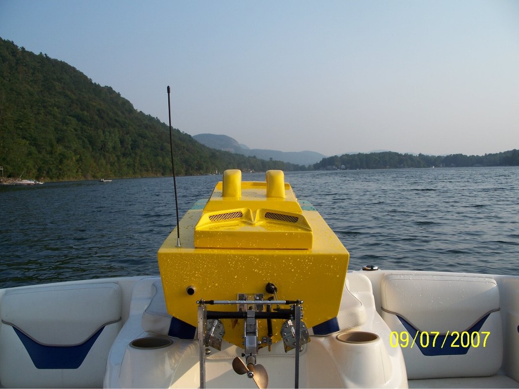

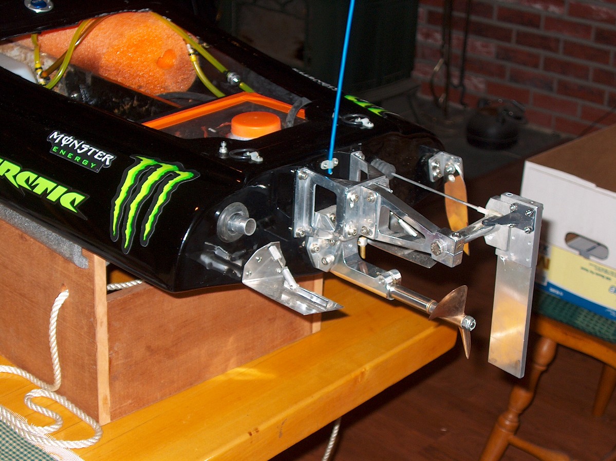

I would shoot for a 30-33% center of gravity from the transome, if my math is correct that puts your balance point at about 17 3/4" from the transome.
here are a couple of pics of my rudder setups hope it helps
