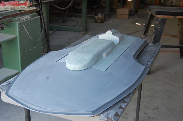

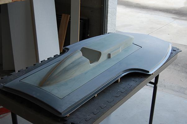

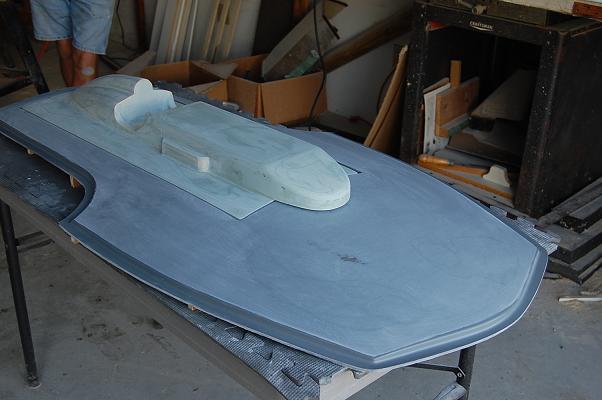

Here is our work in progress for the new Enforcer Classic Thunderboat Hydro we are building.
The deck is based on our popular Stingray hydro hull that fits the size requirements for the IMPBA and NAMBA sanction classes. 50inches -L X 25 inches -W
The boat can reach speeds in the mid-50's with G260 and tuned exhaust. The boat is very predictable and more stable than conventional 3-point hydro designs.
It runs very well in rougher water conditions.
The deck and drivers / hatch were modeled after the Valumart and Schweppes boats of the 60's. They feature a cut shovel nose and a cover for the Merlin / now Zenoah engine, a very nice feature considering the engine must be covered deemed by the rules.
We are also making a hatch that will show the engine for those that want to make a Merlin engine model to cover the Zenoah engine. ( I may even make a kit for that in the future)?
The size is loosely scaled between 1/7th and 1/8th so our driver figure, dashboard, and chrome gauges, steering wheel and fittings kit can be used to really make this boat stand out.
We are offering a couple different rear fin choices that feature a clean-break-away design to limit damage (if and when) the boat blows or rolls in the heat of competition.
There is also a air intake vent on the carburetor and exhaust side and we make 1inch X 4inch aluminum vents that will install over the air intake holes, (looks great)!
I also designed a new exhaust header (7/8inch o.d. aluminum) that will place the tuned pipe inside the hull under the deck to the left of the left stringer. This header can also be used with most other manufactures similar designed (twin O-ring) tuned pipes.
