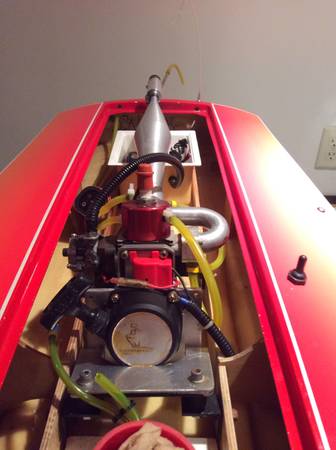

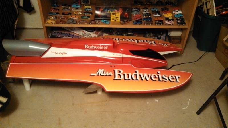

hydropondics replied the topic: need help ...
[attachment=5481]01717_kAHUkzX7xDC_600x450budboat1.jpg[/attachmen
#23513
Motorboater replied the topic: need help ...
Is your receiver pack fully charged, and what do you charge it with? I'm pretty sure the receiver your using is rated at around 3.5-9.6V, and the minimum discharge voltage for NiCd's is around 0.85V per cell (you wouldn't run it that low anyway). I'm wondering if your getting some low voltage spiking. Just thinking out loud.
