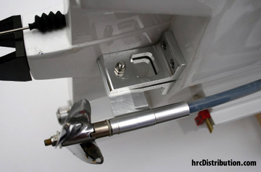

Hi, new on here with some questions.
could someone please tell me how to get the tube not to leak water into the hull? I have tried to fill it with grease but it just flushes out in 1-2hours.
Should i use a gap between the drivedog and the strut on this type of setup? I have heard both, the shaft is a round one.
I have also filled the strut with grease but it also flushes out very fast and the rear bearing have already started to sound bad after 3 tanks of gas.

The grease will leak out whatever you do as the flex pushes it to the stern. If it leaks on the inside you can put a short piece of tubing as a seal on the inboard side of the stuffing tube or just live with it as most of us do. No way I would wait for over an hours running before greasing the shaft.
If you are using a flex welded to the propshaft and a collet at the engine i.e. the flex is fixed then you should have a gap at the strut, 6-8mm, as the flex shortens under power.
Might just be the picture but it doesn't look like a brass stuffing tube going into the strut, looks like just a teflon tube. You should fit a brass stuffing tube to guide the flex. You can use a larger one and have the teflon inside or just ditch the teflon and run with brass, most do.

jorekore replied the topic: Flextube leaking
Ok, tighter maintenance to the shaft and tube then.
The shaft is welded to the propshaft, on the engine there is a clutch with a collet and on the prop side there is an adjustable strut so the shaft is fixed, the boat came with no play at the strut so i thought it would be that way, if i adjust the gap to 6-8mm the rear strut bearing will be loose since it is nog glued or welded in place?
You are right, the tube is a teflon and no brass, could i fit a brass ond with teflon liner and still adjust the strut?
The boat is a rtr segad 58" that i have mounted a 29,5cc 7,7hp engine in, have only tested it once with the pipe 40mm to long, i have shortened the header and will try it again this evening.
