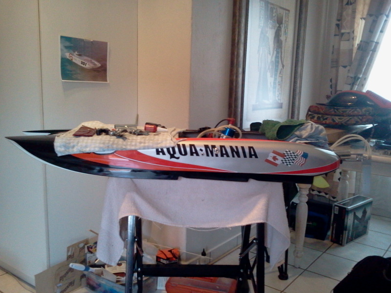

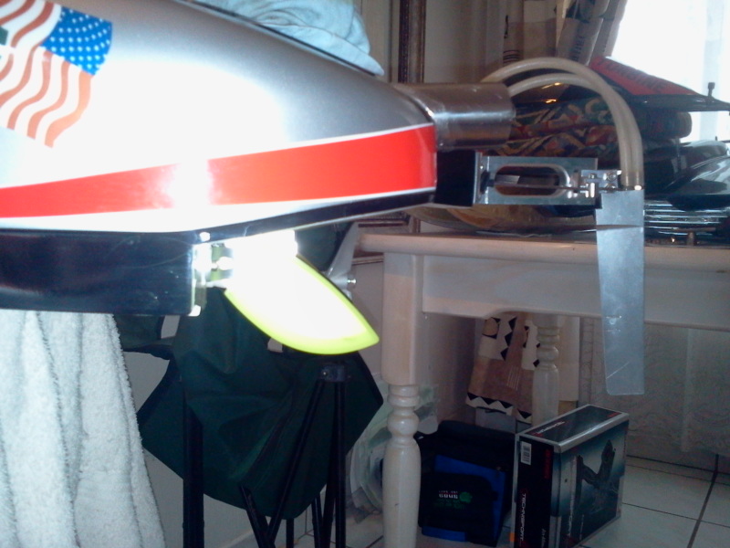

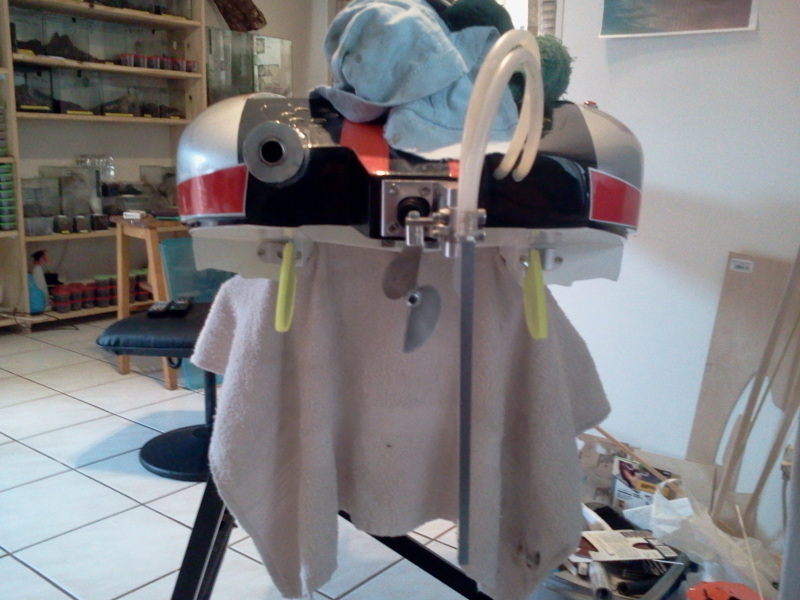

Hi guys. I fearly new to this amazing hobby. My problem is this, i know the boat is not a racing cat by a long shot, i really like the boat and would like to tweak her for max performance, straight line speed is great but damn the cornering sucks, turn to fast and she will do the barrel roll like she was born to do it. I would appreciate any advise in getting the set up right.

Why not take them fins off the bottom. Cats never need fins.

Just like Neil said I never seen Fins on a Cat before
maybe that could be the problem in your turns them fins
are hooking up in the turns.

Canadian Hot Rod RC Boats replied the topic: Re: Cat barrel roll
Exactly ... the rear will 'slide' some but with fins its like having 3 rudders with 2 always going straight and in corners will 'fight' till one gives
usually a snap roll will follow :sick: ... which is eaxactly what u have
JMO ... lose the fins

Only change one thing at a time. You don't know if the changes did anything if you do several things at once. Try it without fins -- if need more 'hold' in corners go to a skeg strut.
But only change one thing at a time and test ...
