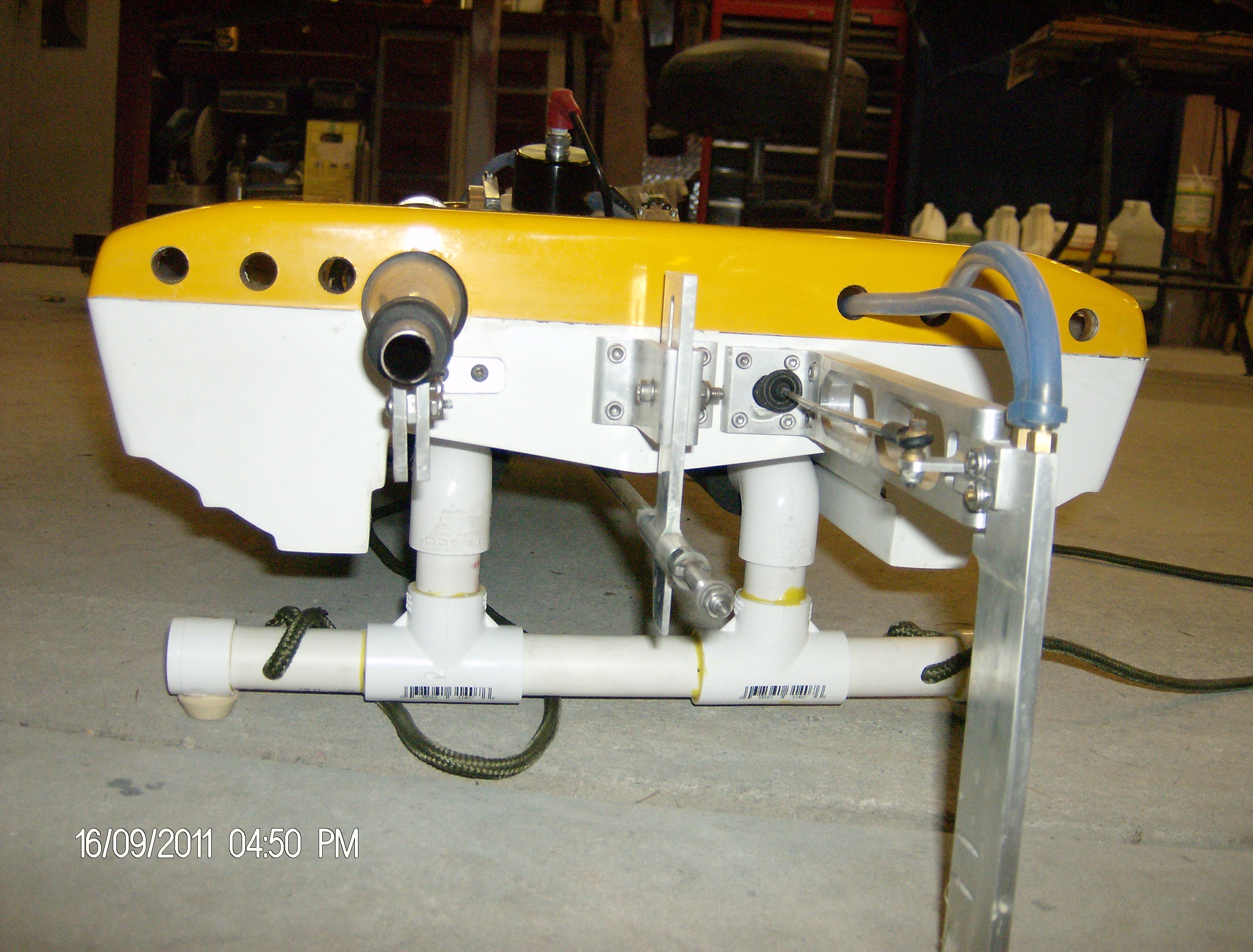

Butch replied the topic: Re: Cat cornering
[attachment:1]C:\fakepath\rigger and cat 011.JPG[/attachment]
[attachment:2]C:\fakepath\rigger and cat 011.JPG[/attachment]
[attachment:3]C:\fakepath\rigger and cat 007.JPG[/attachment]
how about this ?
