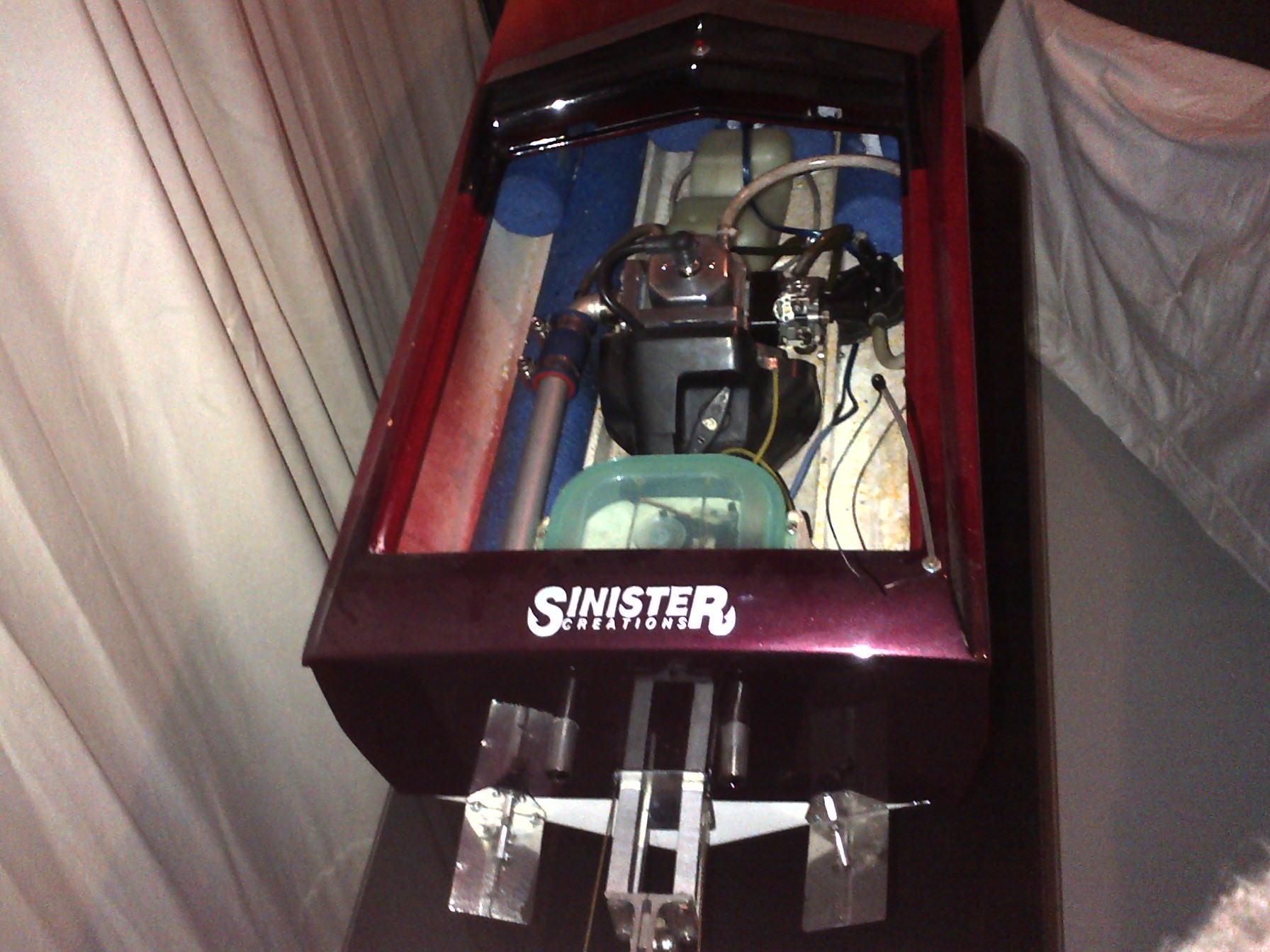

New member here, getting back into the hobby after a long hiatus. I've got a 56" Capricorn Apache and I'm looking to try and squeeze some more performance out of the boat. I've outgrown its current performance to the point I'm a little bored with it and I'd love to squeeze some more top-end out of it. I estimate it runs 30 mph give or take as it sits with the following setup;
-Mcculloch 32CC engine (stock internals)
-Walbro WA-167 carb with velocity stack
-Home made wet exhaust (non-tuned)

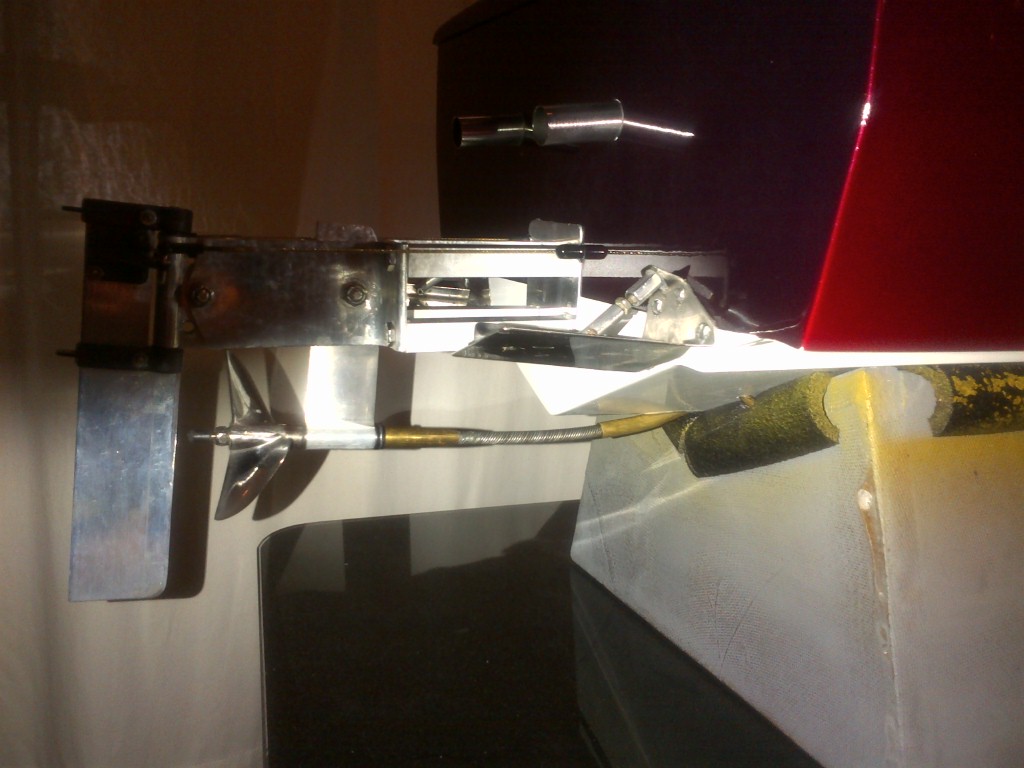

-Octura Strudder drive set back 3" off the transom on spacers (set sub-surface)
-Prather 275 2 Blade Prop
I figure a tuned exhaust setup would help however they appear few and far between for the Mac engine. The only setup I've found is this one;
www.americanrcboats.com/produc...es/engmacex.htm
I already have a wet header on the motor so really I just need the pipe but haven't had any luck finding one that suits the motor.
Second I question whether going to a surface drive and different prop would be an improvement. When I built the boat the hull designer really pushed the sub-surface setup. Most of the big gas vees I see run surface drives so I wonder if this was a mistake. I'd hate to cut the hull up to move the drive unless its really going to be worth it.
Any suggestions are appreciated. I have some pics of my current setup if anyone would like to see.
