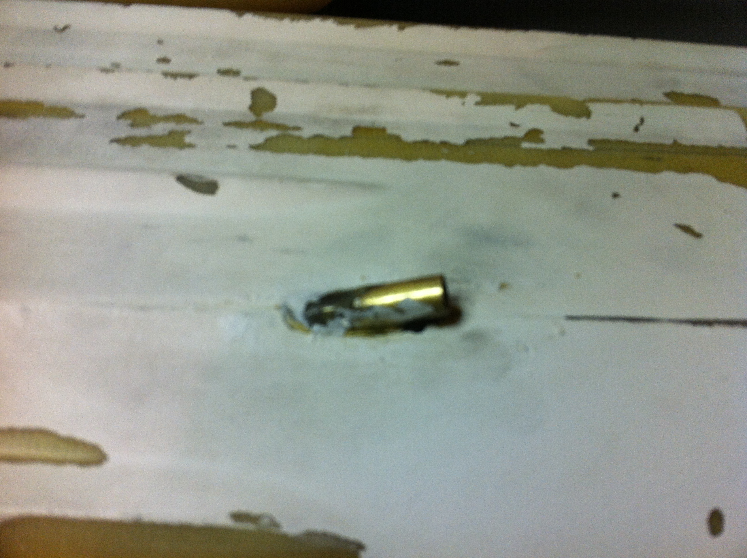

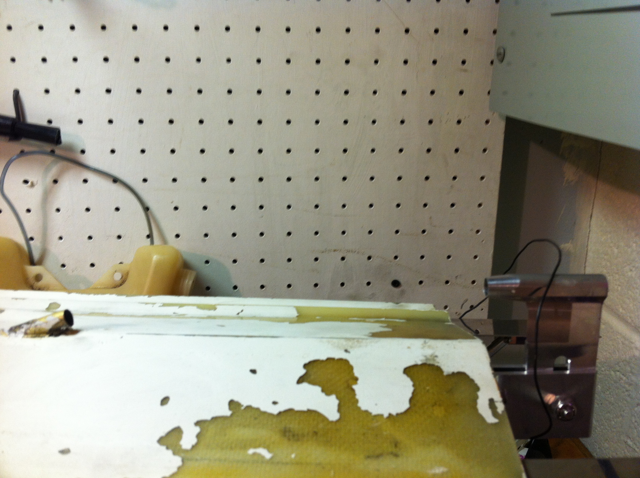

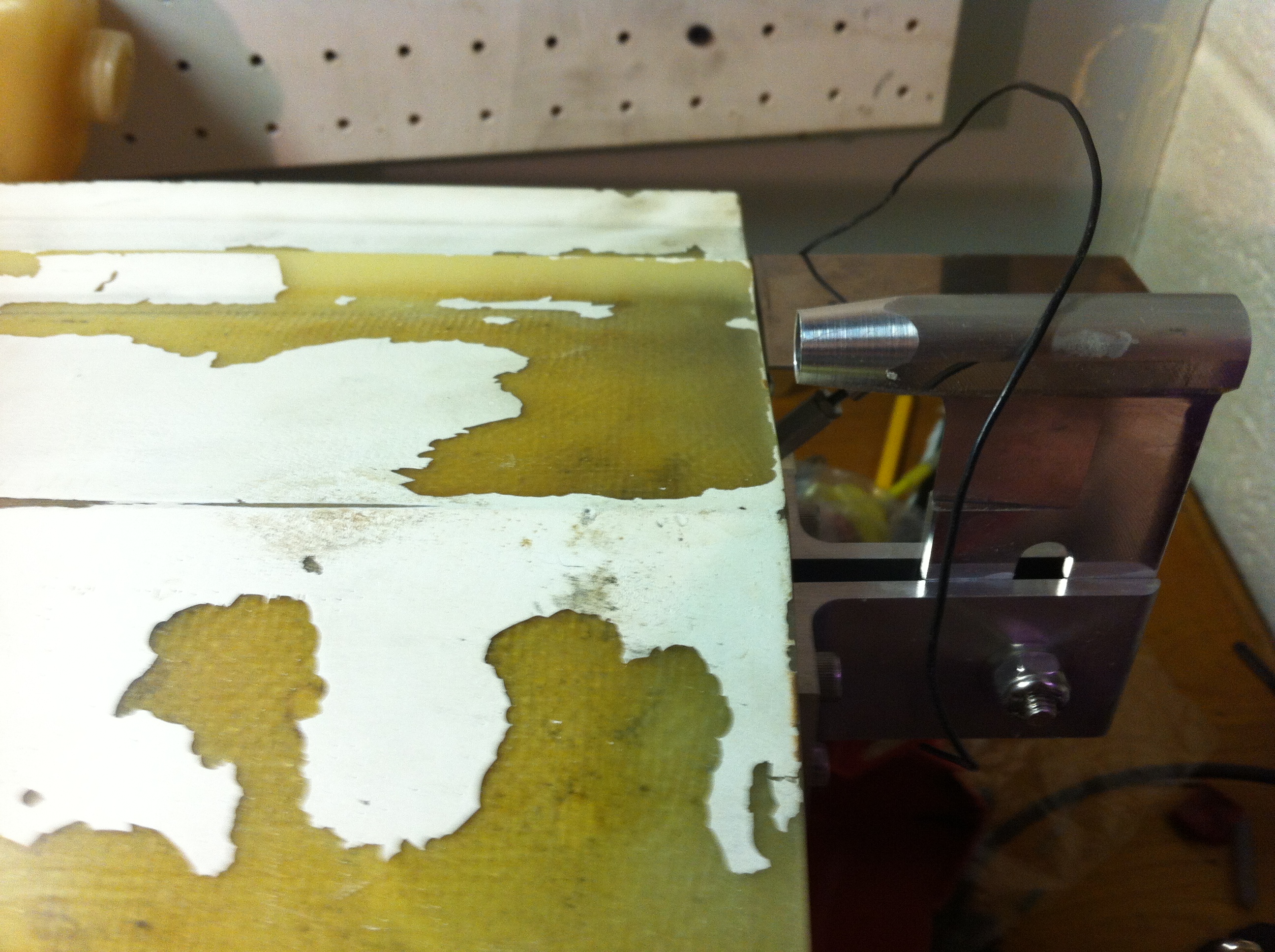

Hello everyone i have a mono hull boat with the fexshaft comig out of the bottom of the boat and the flexshaft connects to the strut my problem is what is in between the bottom of the boat and the strut to keep wate from getting in. Thanks to whoever can help and sorry about the bad spelling im on my phone
I posted the pics let me now what you think and the flexshaft is 1/4 so if anybody knows where to buy the part im missing please let me know and also the boat hasnt been gel coated yet so it looks like crap right now whoever had it before me just put paint on it so i have to sand it all off and put gel coat on the boat

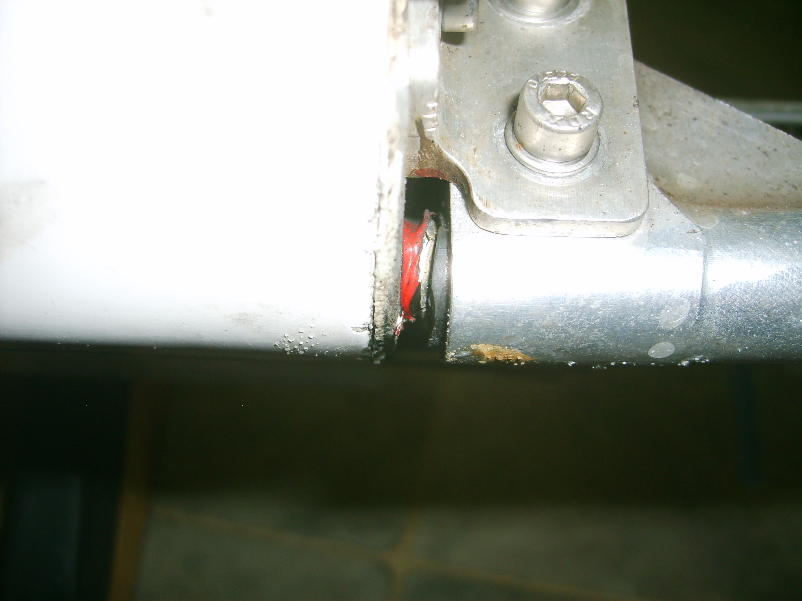

not sure bout the fleshaft coming out the bottom of hull on a mono as they ussually exit the back of the hull unless its a cat in which case the have a teflon or simillar tube thet flexshaft runs in see pic
on mono hulls same thing if strut just shorter or like my Apache stinger i have a brass tube instead of teflon and have sealed with silicon
but as the motor is mounted low to assist with lower COG and flexshaft ressistance i do get some water enter when stopped but when moving the inertia pushes water to stern and auto bailer takes care of it

had a look at the pics and somthing isnt right very unusuall setup for a mono IMO see pics i posted of Apache where exits stern straight into dtrut/stinger . that setup looks like it would create a load of drag and you couldnt trim the prop correctly it should be right on the surface ( for speed that is) i could be wrong and someone out there may have seen a setup like that before

Ive seen a couple mono hulls look like this and they aren't really that fast but they go about 20-30 mph depending on how its all set up in the end.This is a older fiberglass hull and it was made by futaba.

Looking at COLOR of hull under the paint and what else can be seen :blink: ... looks at first glance to be an EPOXY hull likely being a PRATHER.
Because these are SHALLOW V type hulls they are best set up as sub surface piercing as shown.
An out the transom true SURFACE drive will tug the transom around REALLY BADLY from prop walk.
