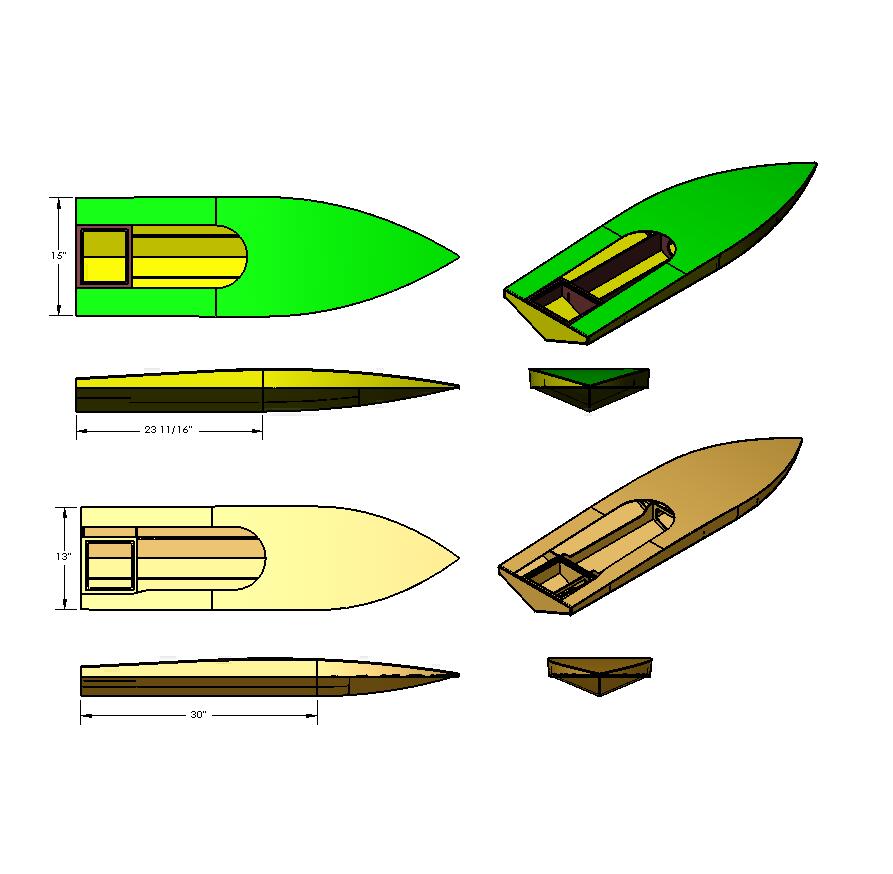

Hi i wanted to know really what the diff in the two boats is? I have a new 27cc sikk engine and was think what one to build.I have build the wildthing with a weedy engine it works good for what that engine puts out.

dwr9 replied the topic: Re: prowler vs wildthing
The prowler is 2 inches narrower and the bottom was changed slightly. Doug

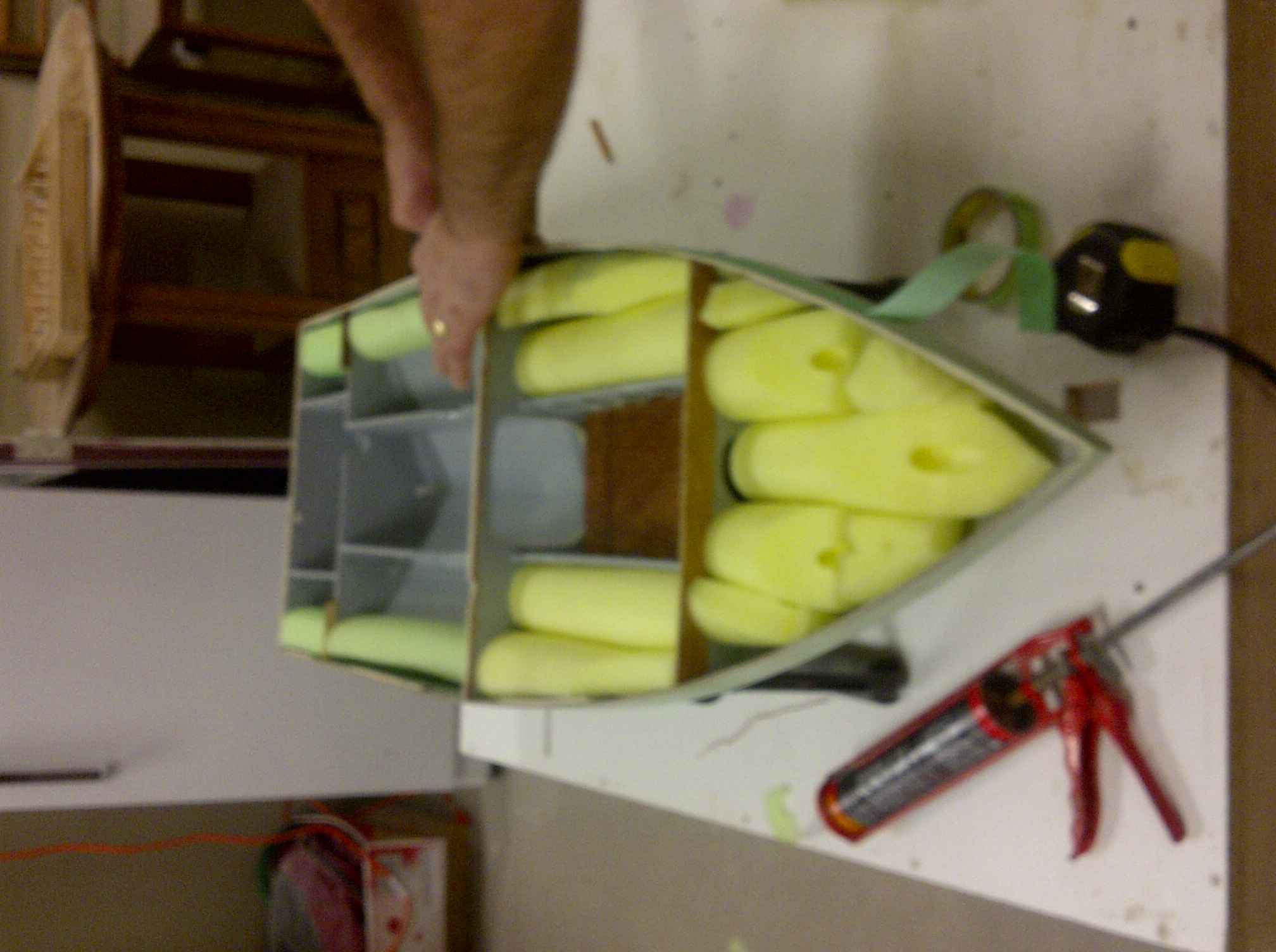

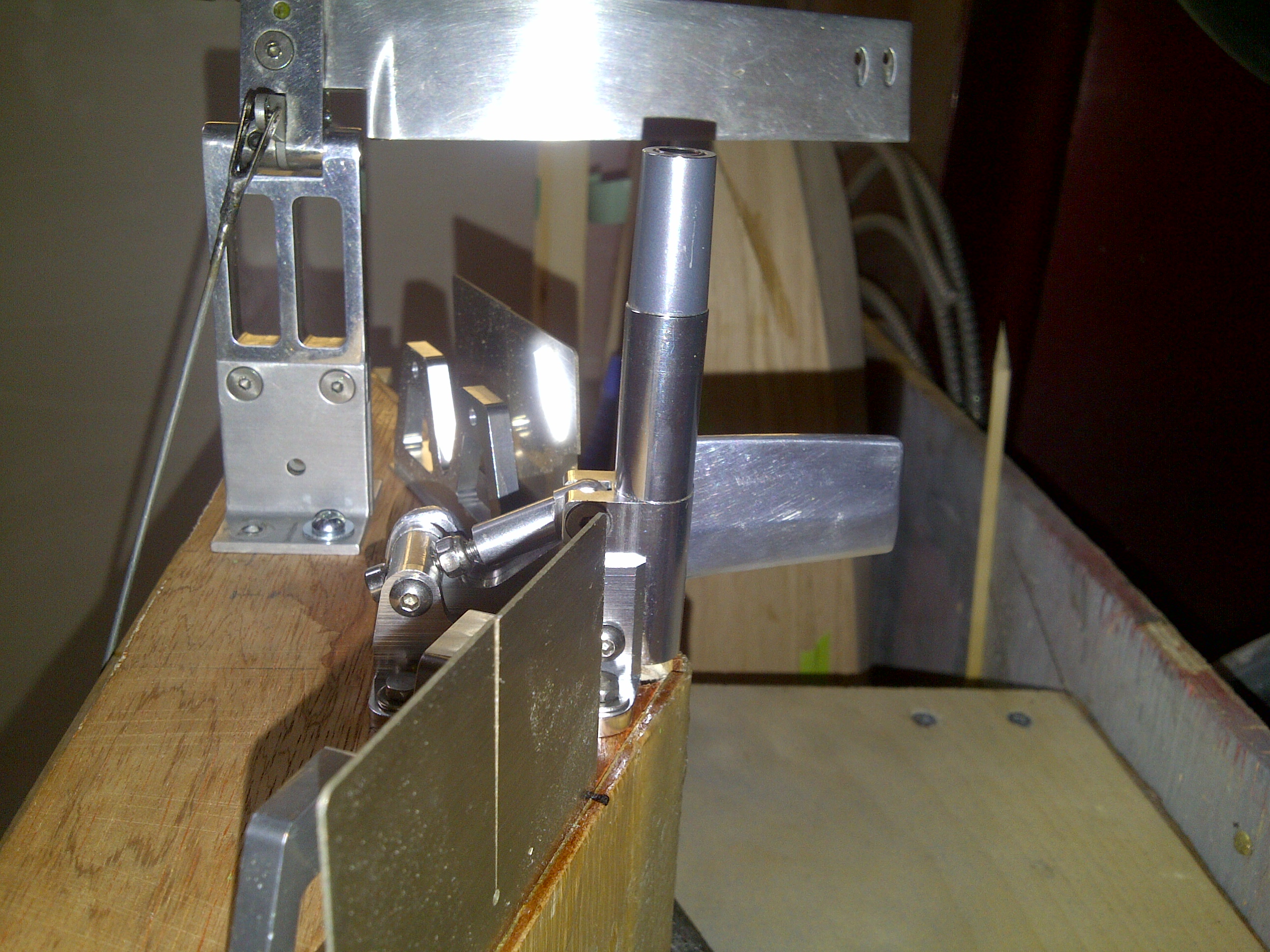

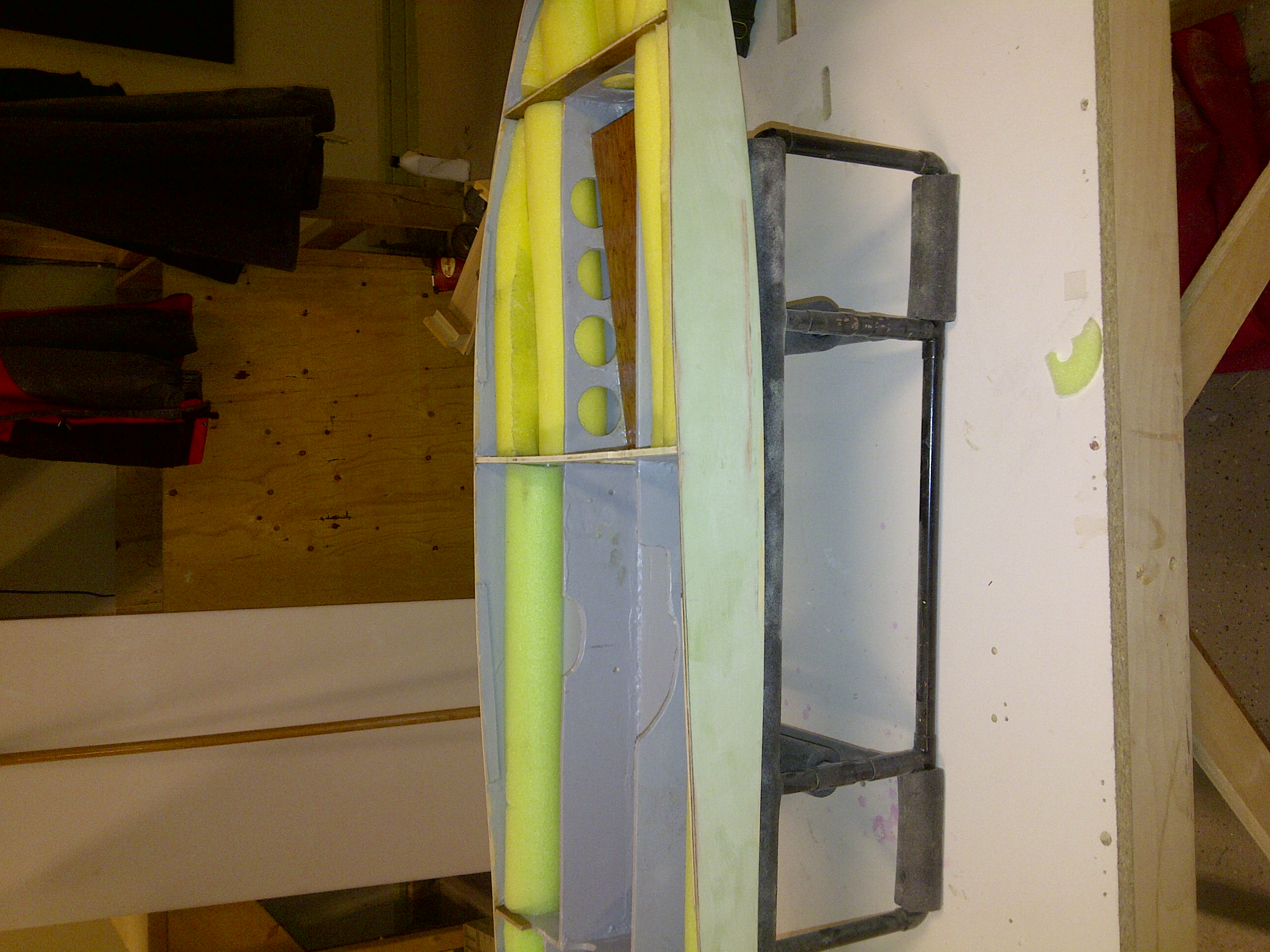

larryosbourne replied the topic: Re: prowler vs wildthing

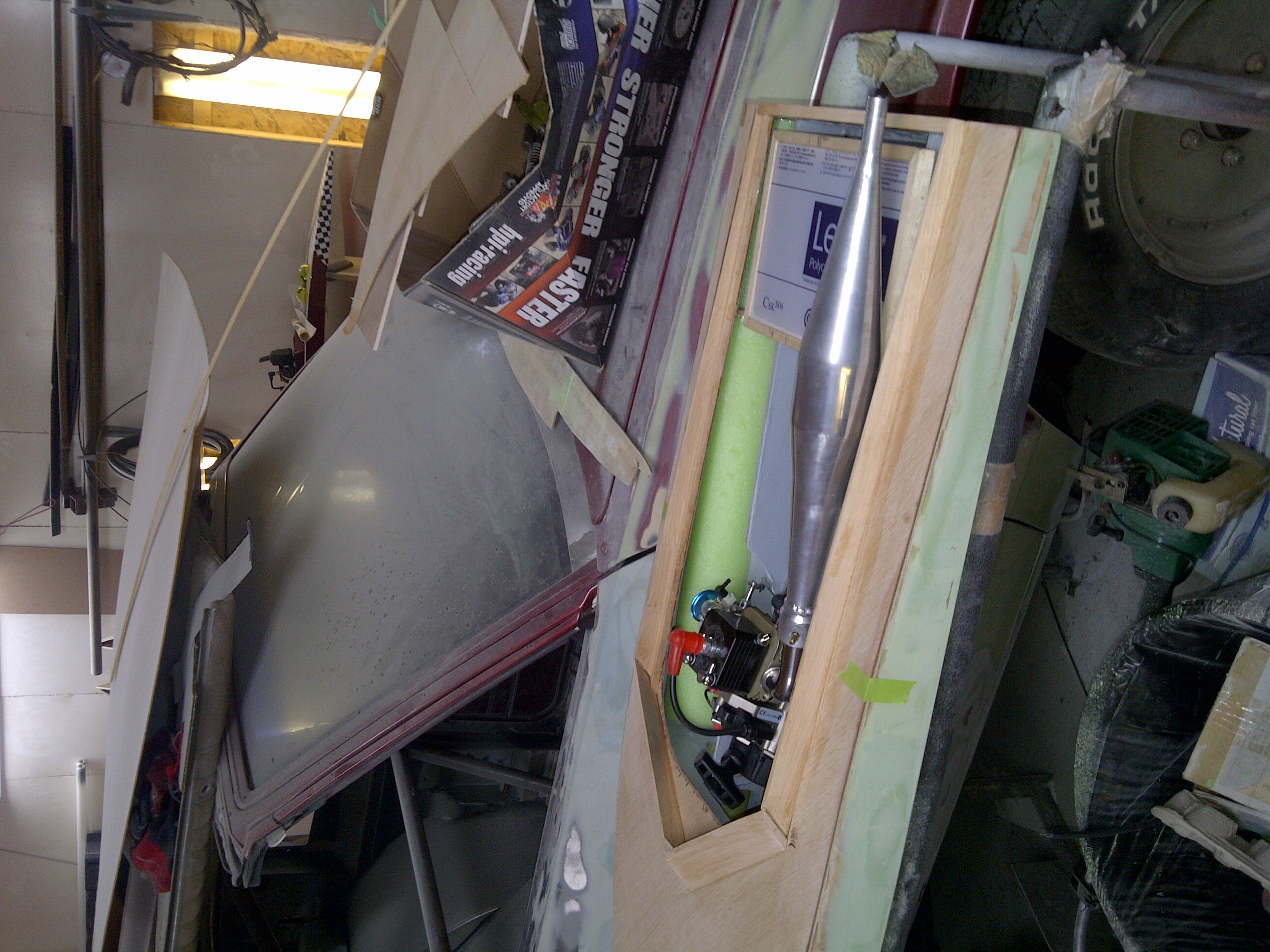

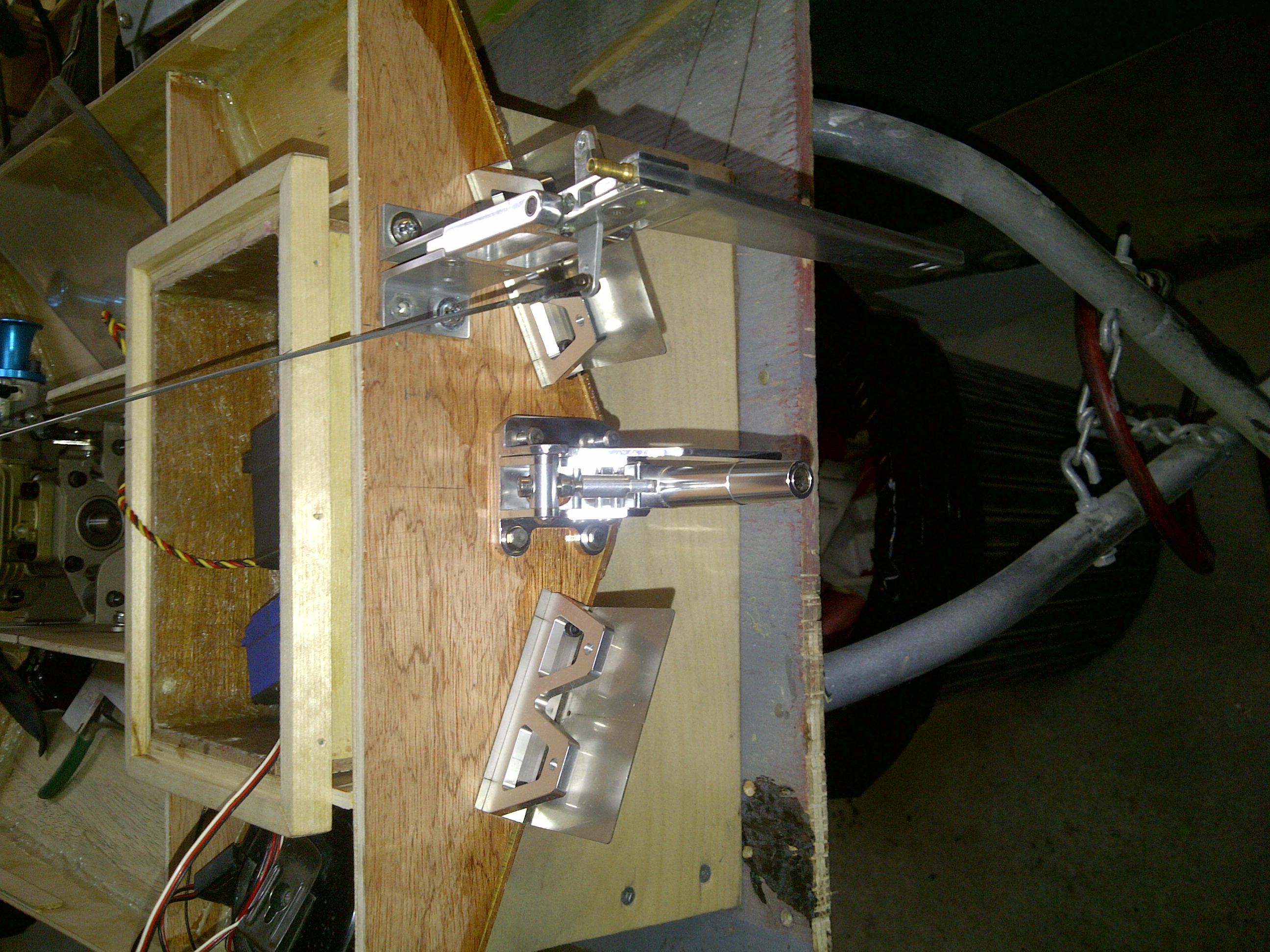

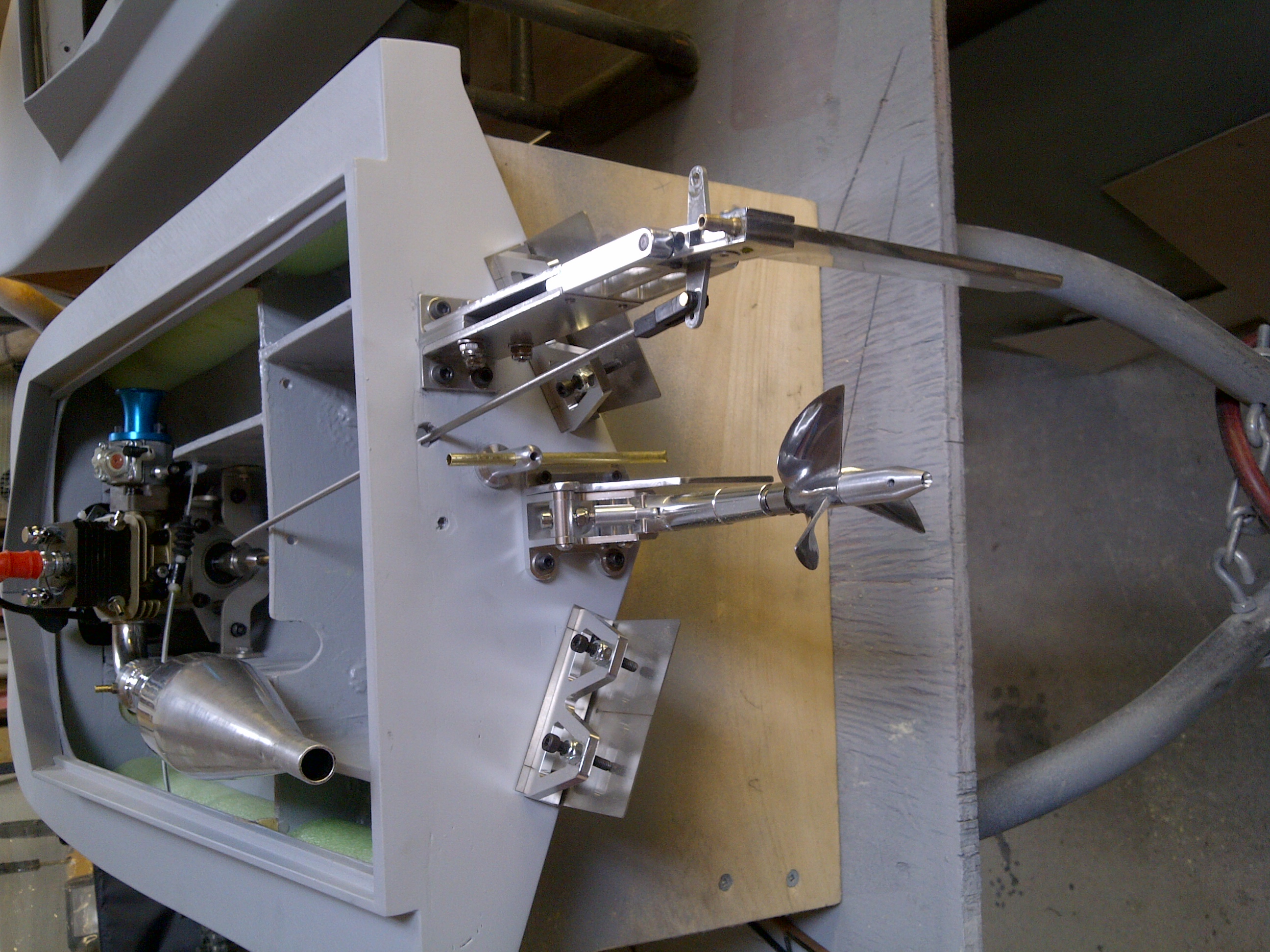

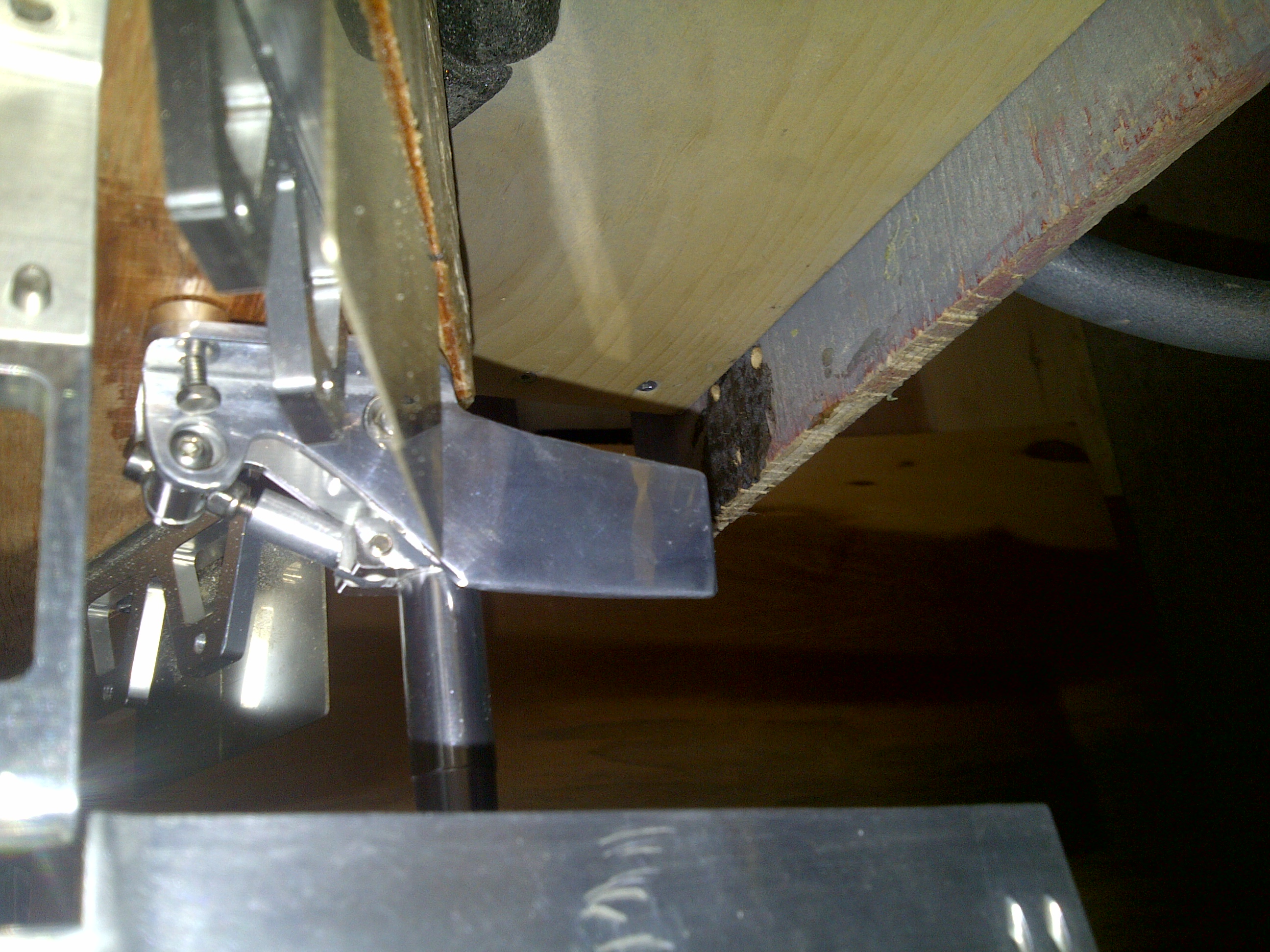

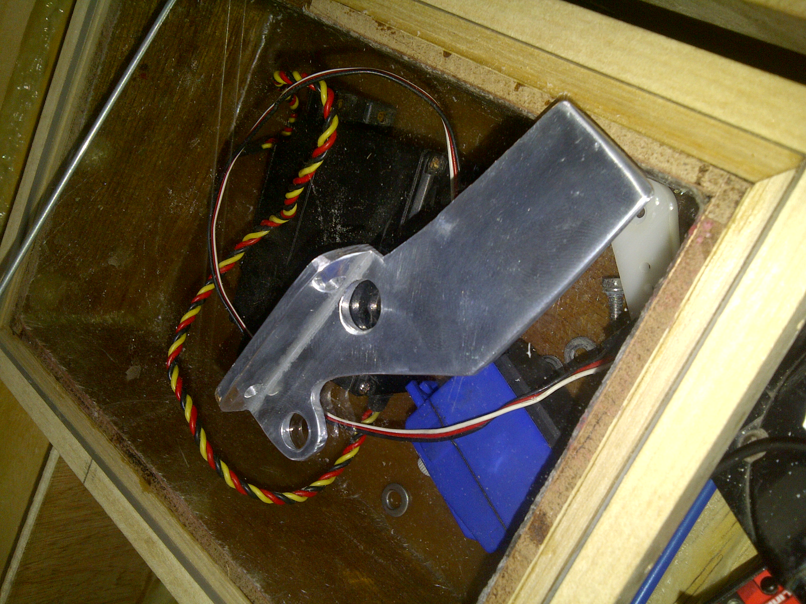

some pics of what is done up to last week i am not using turn fins like most do.I made a fin for the bottom just like the silex pro hays on the stinger,this is some pics to see what it looks like.

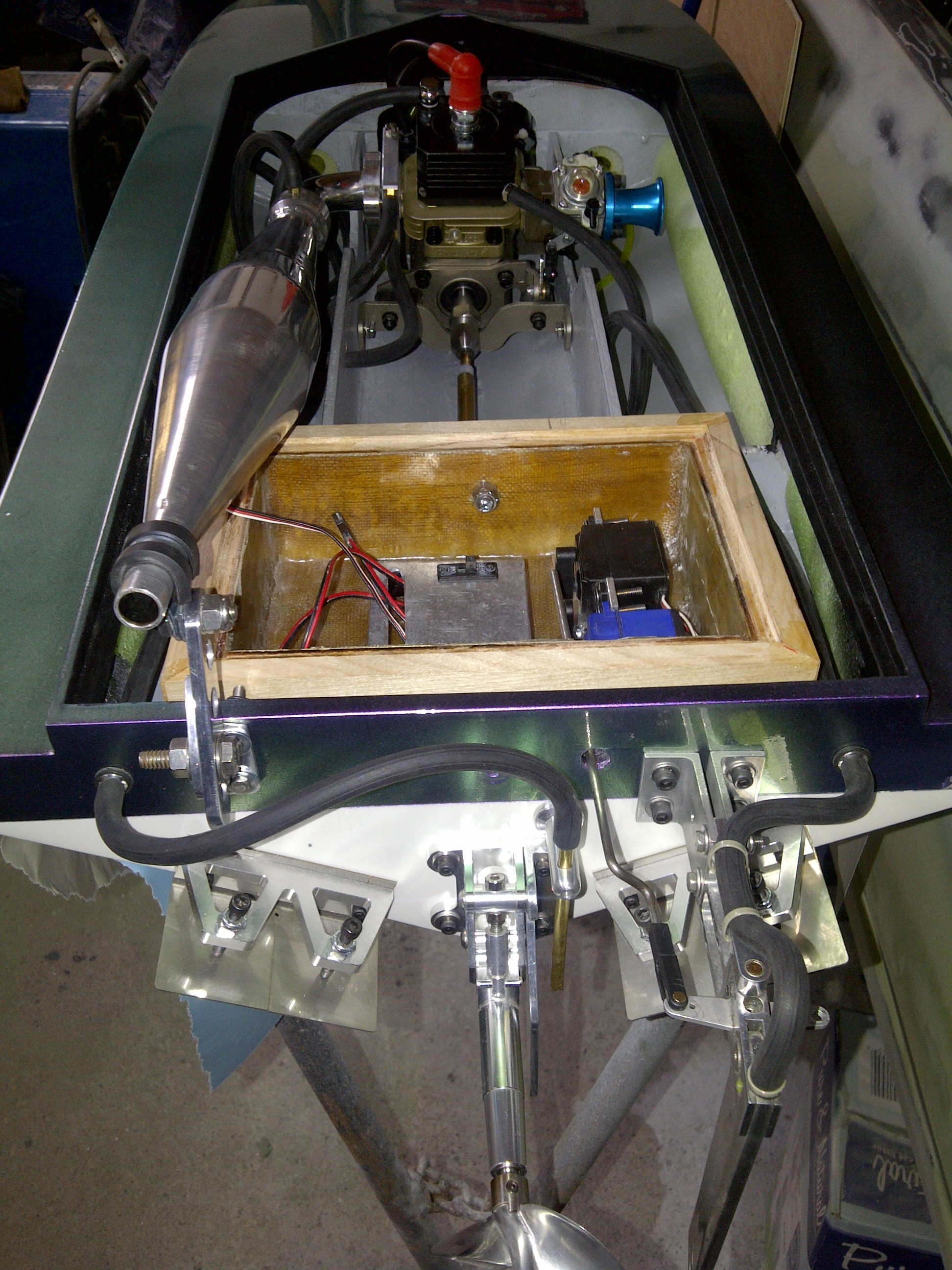

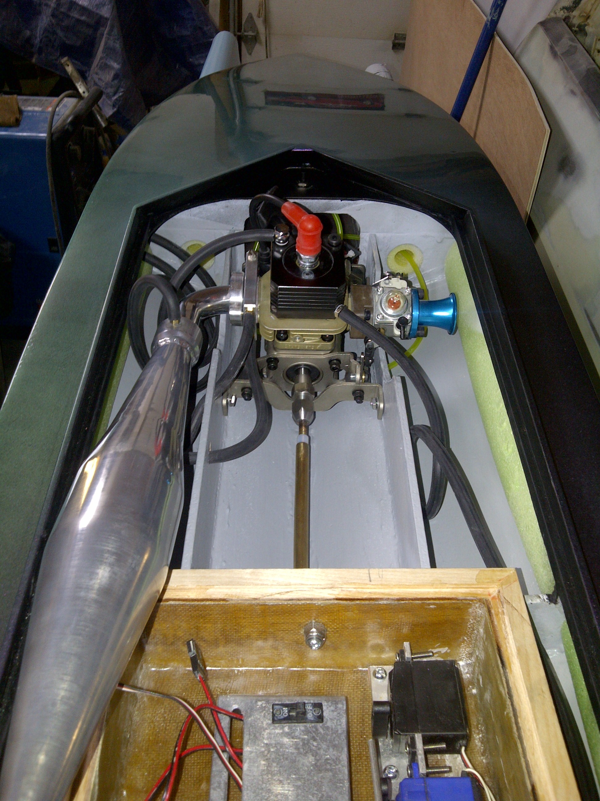

#18137

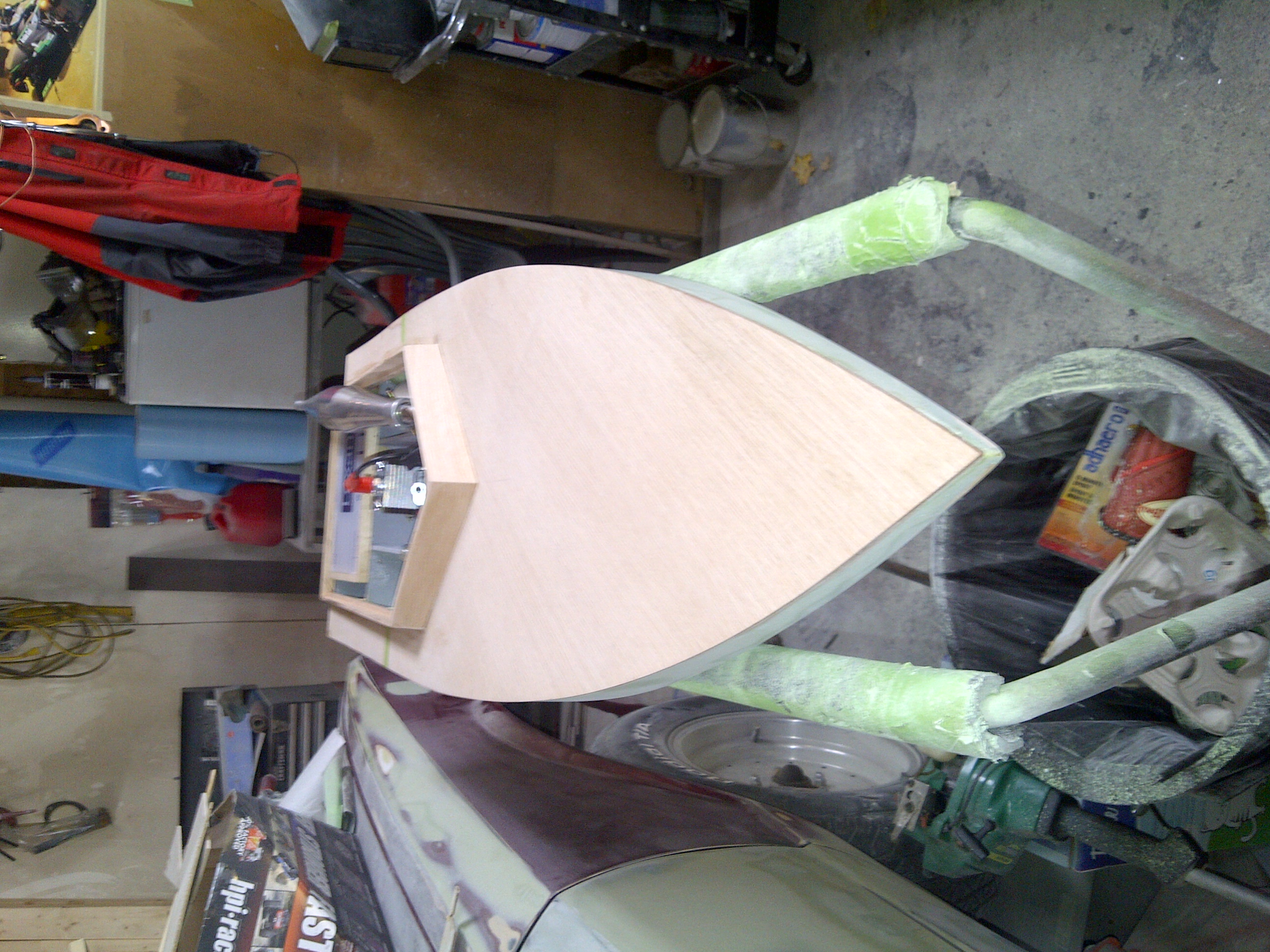

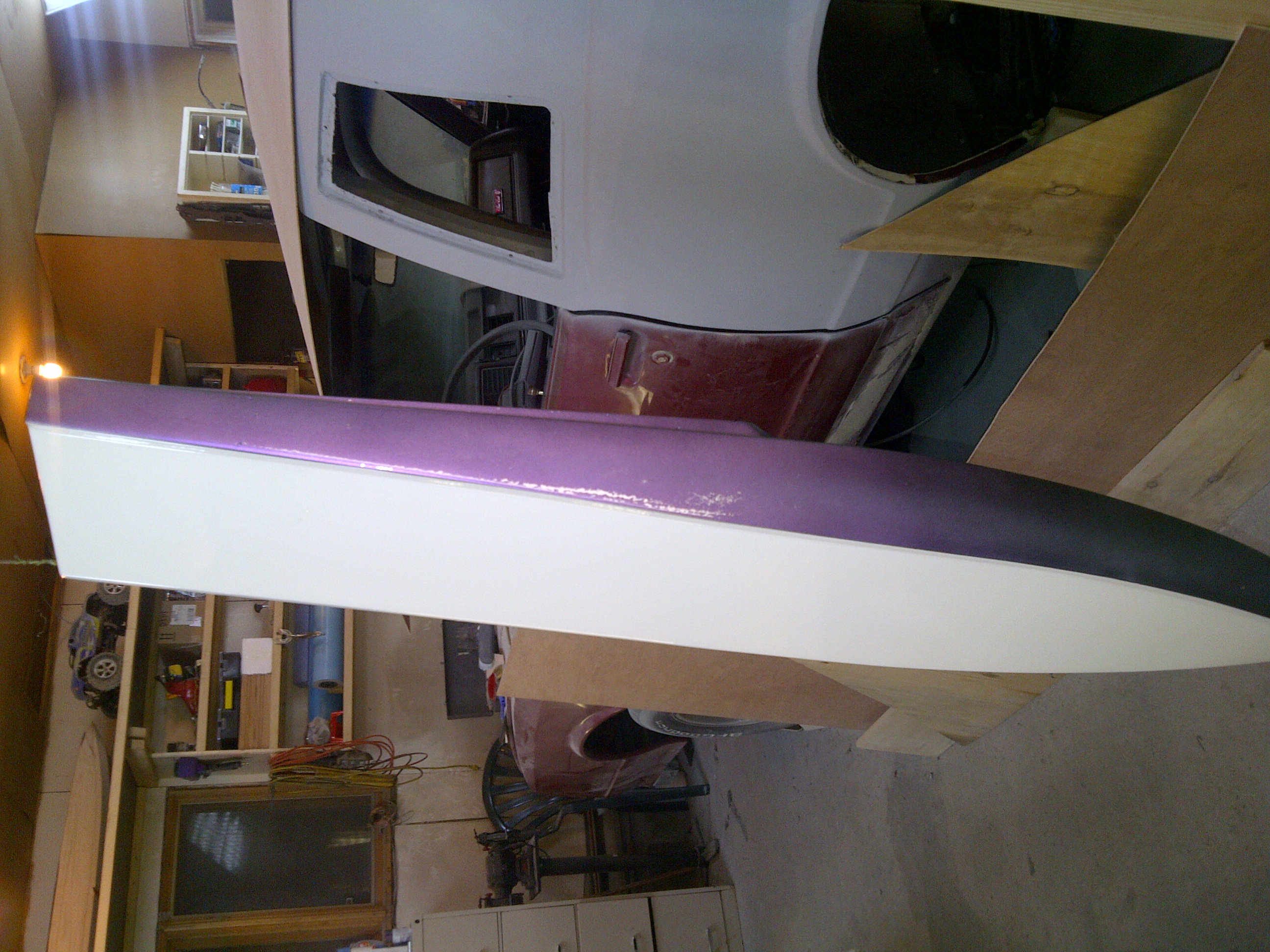

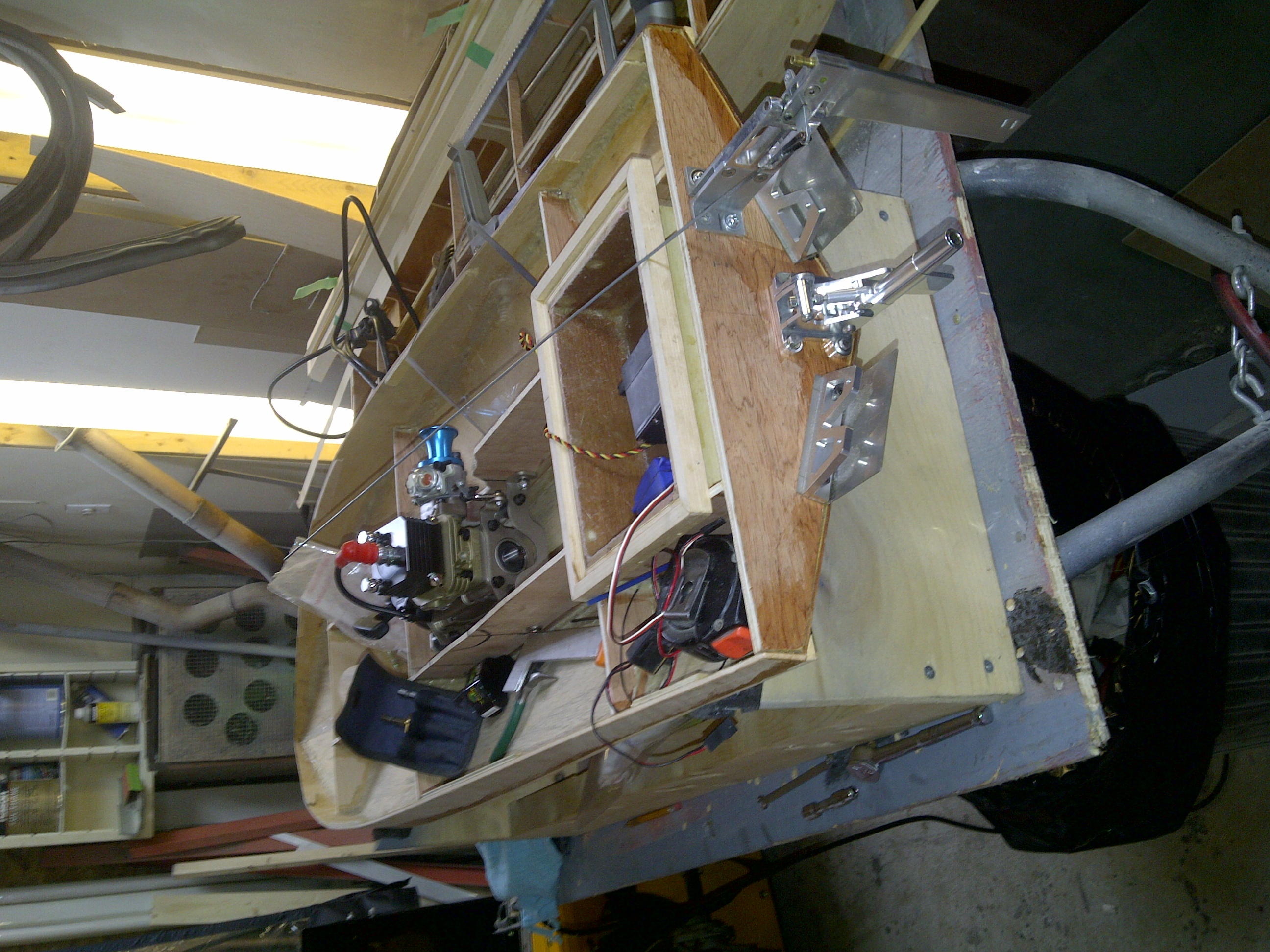

Hi some update on my build i hope you like.

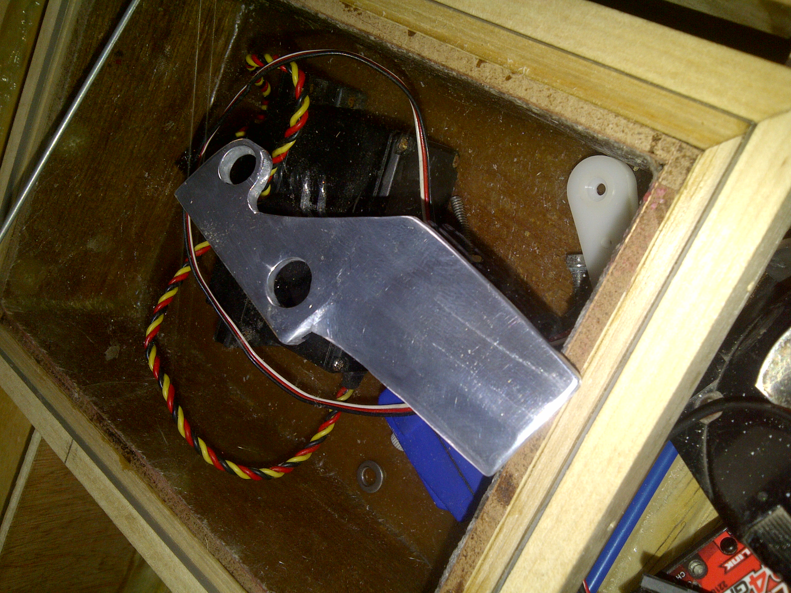

#18307

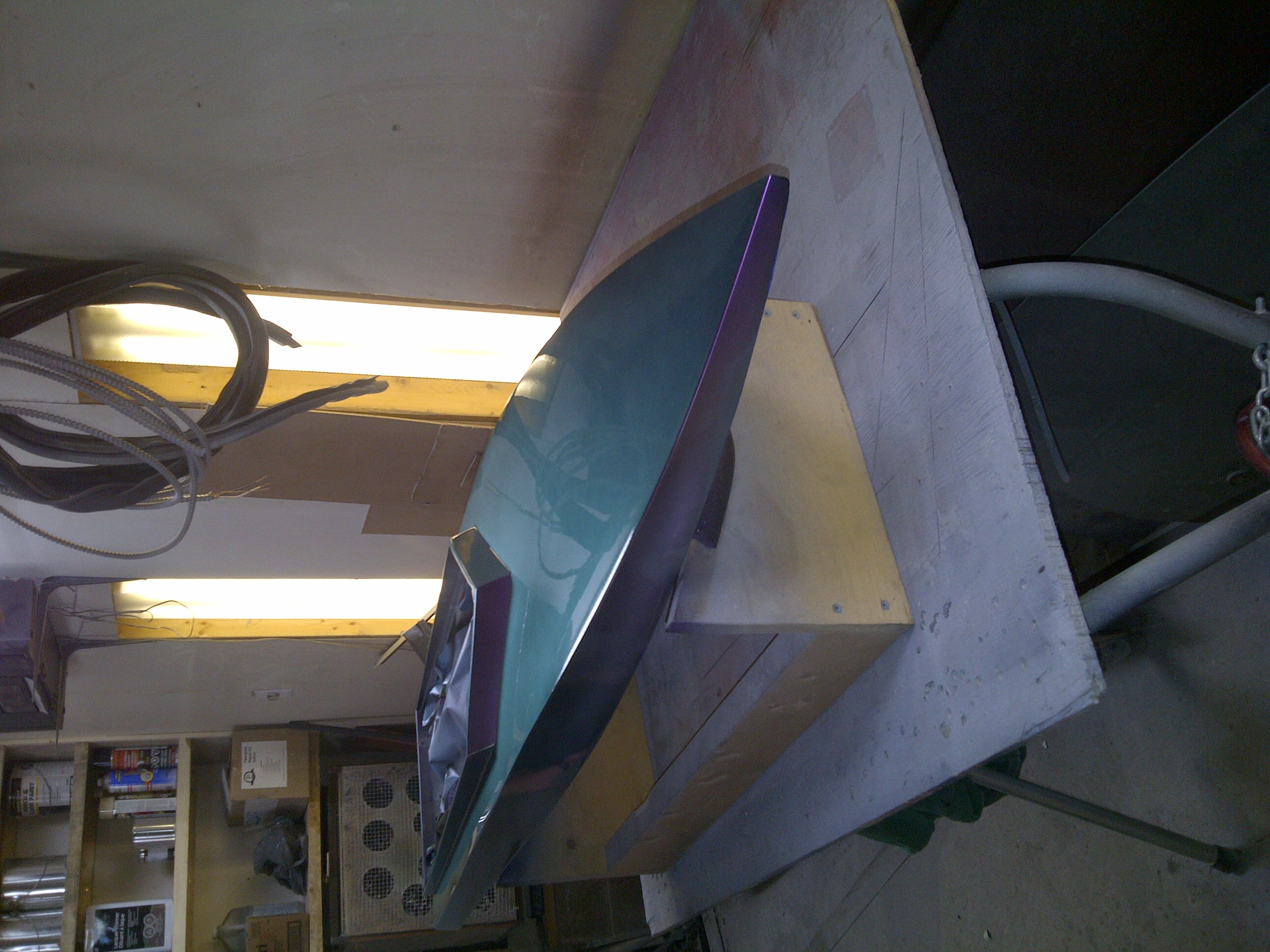

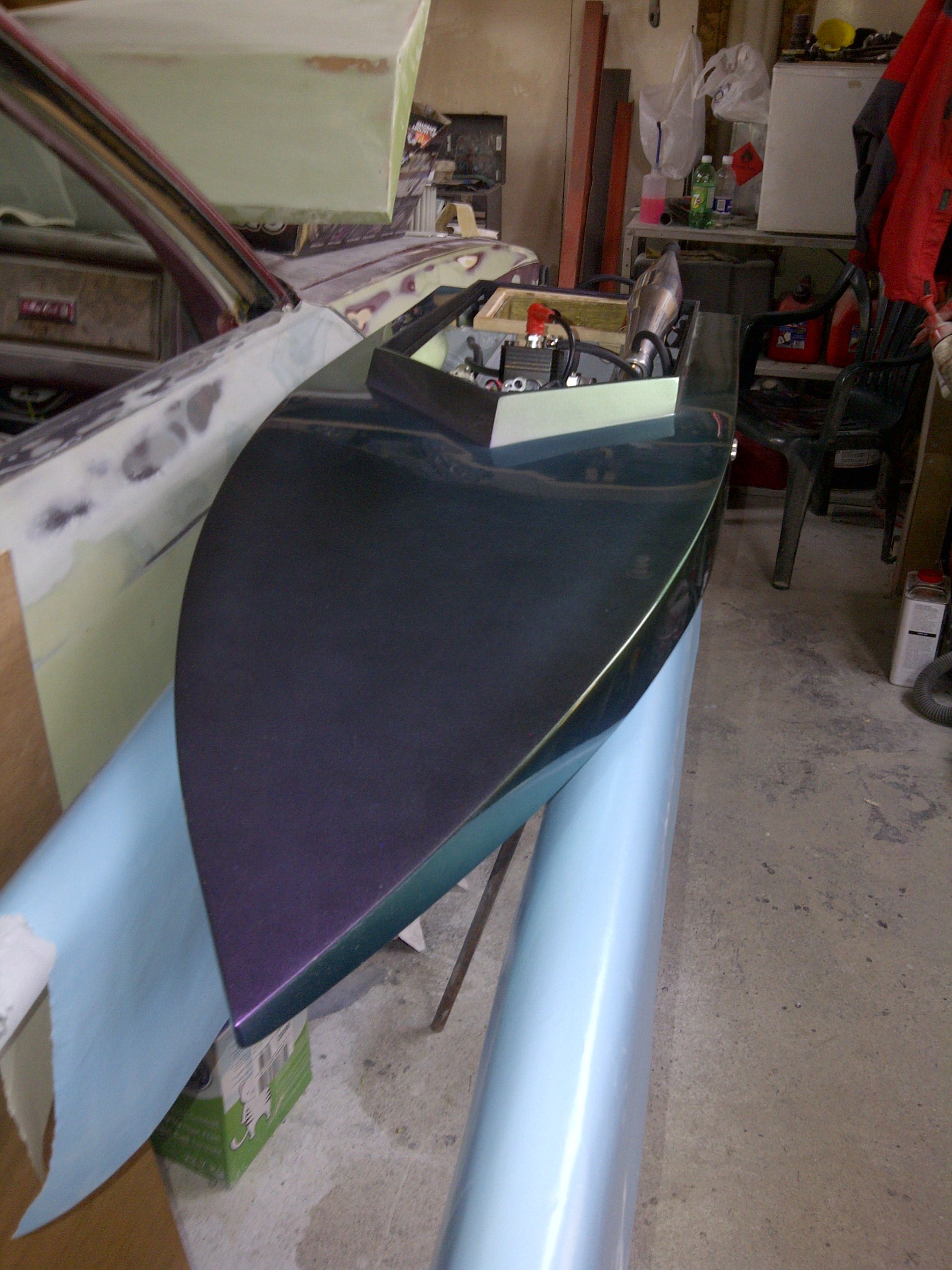

Now starting to look like a boat
#18587
The paint looks really nice. Doug

whitefish replied the topic: Re: prowler vs wildthing
One super sweet build!
Please keep us posted on how it performs. Once the setup is
adjusted that will be a screaming mono.
