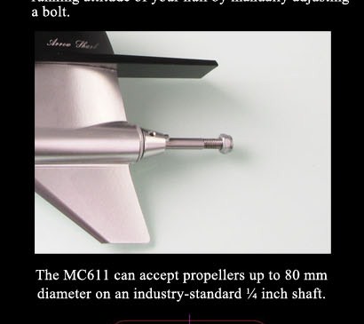

I have ordered two "MC611 Sterndrive" from www.arrowshark.com for my 56" mono in built.
Now I need the best advices I can get about where to buy two quality props (normal rotation + counter rotation). Diameter appr. 68-72 mm on 1/4 inch.

What's this about? Some prop sites talk about "dog drive". Others don't. Most are just about 1/4 inch threaded axels and maybe a locking nut.
What should I look for to get a fit to the Arrow Shark MC611 drives?

It takes a standard 1/4" dog drive prop (normal gas props) the dog drive engages front and nut holds back
www.arrowshark.com/MC611.php
