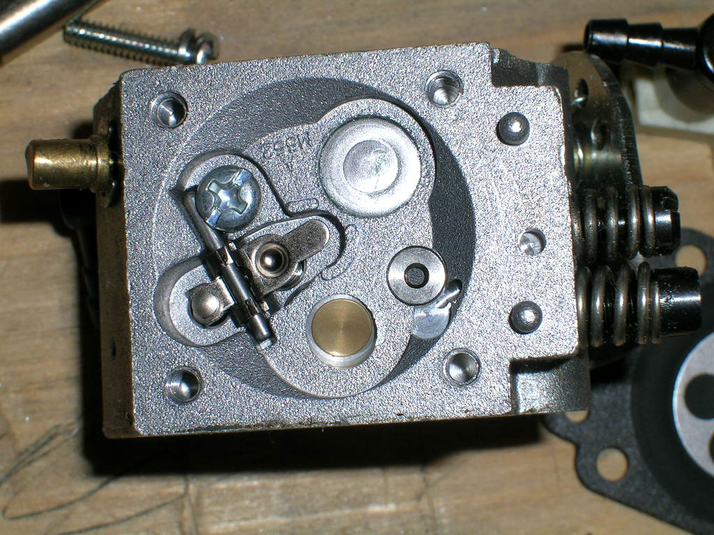

If that's a 644 (which it sure looks like) and you attacked with with compressed air, you more than likely blew the check valve in it. Seen many guys trying to figure out why their carbs no longer worked after doing a maintenance on them... most of not all of the guys that used compressed air blew the check valve. It will never pump gas.
Its a little insert in the carb with a hole in the middle of it. It's about 3/16" diameter with a small hole about 1/16" in it. Inside you should see the hole blocked by a rubber flapper, flush against the opening. If you don't see that, or is out of shape, you have to replace that part or chuck the carb. That valve is pressed into the body.
Surprisingly, not many people know about this. I would be curious to know how many perfectly good carbs went to the garbage bin because of this! lol

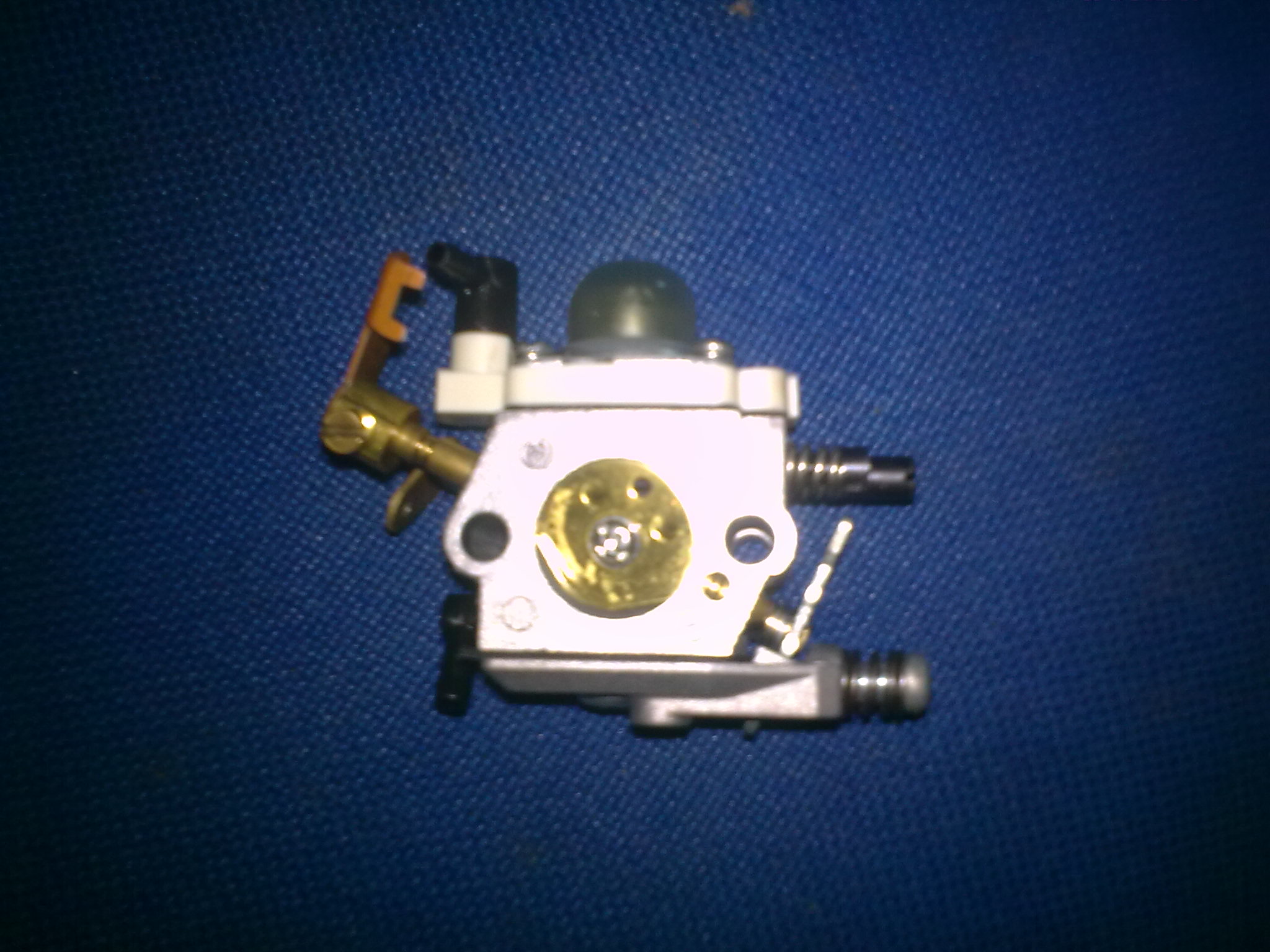

I took a pic to show you. It located under the metering diaphragm. In the picture the valve is at about 4 Oclock.
The 257 carbs don't have this.

I looked into the hole in the valve and can only see bare metal so I'm guessing the rubber flap is gone. Any Ideas on how to get it out of the case....I'll probably have to destroy it yes???

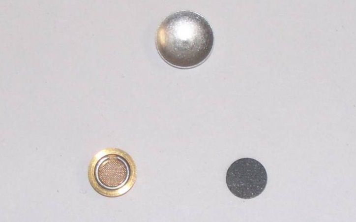

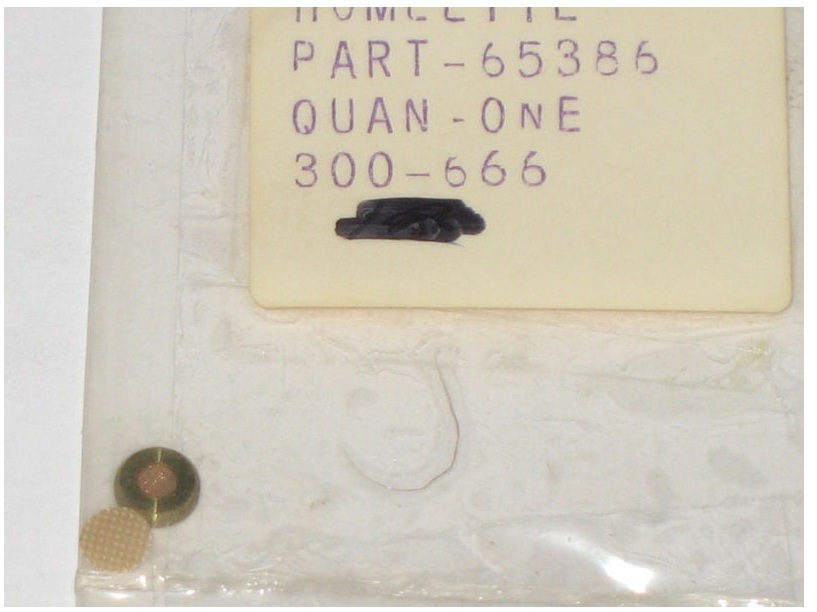

I'm just wondering which rebuild kit to get. Should I get the K20-WAT or is the K10-WAT sufficient and does anyone know if either of them contain the check valve I need.
Is this the check valve I need???
Or this one??

This link should help you out. I'd say the first pic you showed looks more like it.
www.ereplacementparts.com/walb...818_141493.html
I've replaced the check valve in a few carbs, and had to destroy it to get it out...mind you it's already destroyed! Just don't mess up the body where it seats. Might be faster to just get a new carb though.
