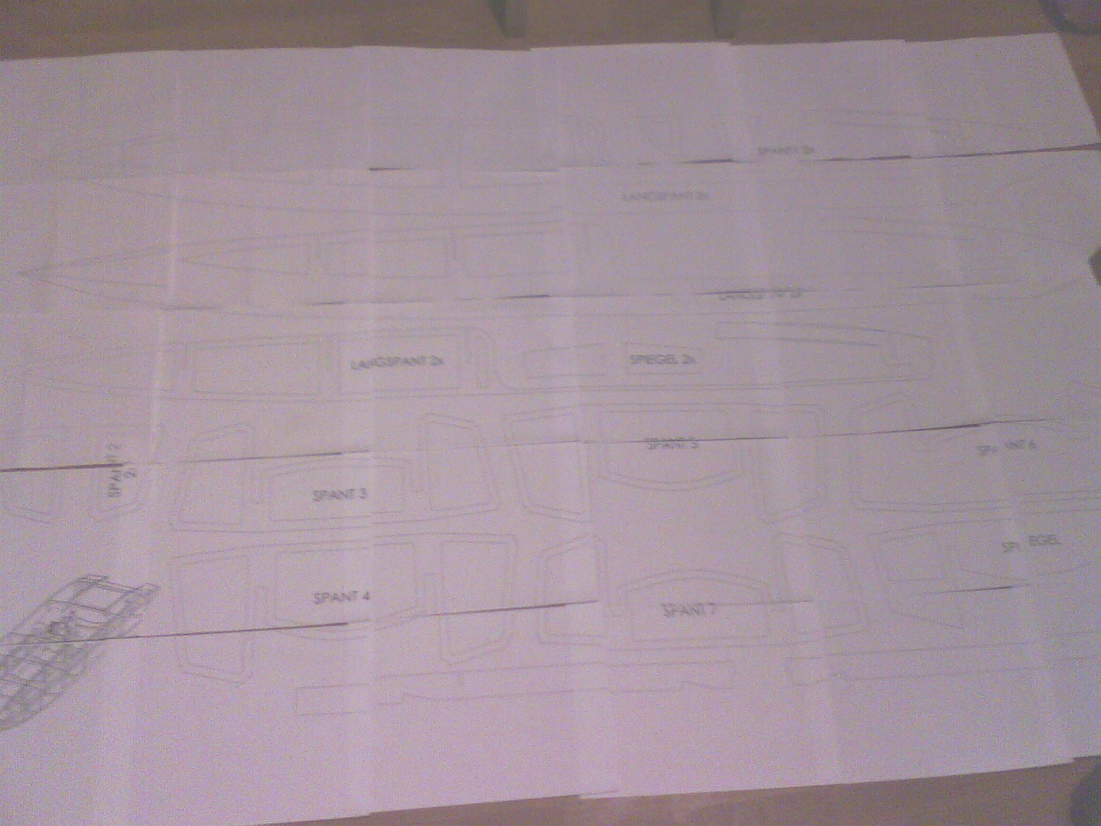

Hi all im wanting to build a cat from the plans on this site but am unable to enlarge them to size so i can use them as templates,can anyone do this for me and if so i don,t mind paying please email me at This email address is being protected from spambots. You need JavaScript enabled to view it. if you are willing and able to do this for me.obviously i will also keep pictures of the build as it proceeds so everyone can see on this site.Thanks in advance Darren

dazzido replied the topic: Re: anyone able to enlarge plans
Hi i do have a printer but only A4 size and when i size the plans obviously they are too small if i try enlarge them i just get an A4 page with maybe a line on.not sure how to do it.the plans im wanting are here.cheers DAZ

Ian Webster replied the topic: Re: anyone able to enlarge plans
You need the ability (and appear to have that ability) to "tile" the print on your printer. As the page is large then you are going to get some pages with just a line on. Do a tile print with no scaling and then stick the pages together. I admit getting the pages in order can be tricky but you just need to work out if it prints left to right and row by row or from top to bottom and then by column.
Ian spot on m8 did like you said and voila done thankyou my friend.this boat is one big mother,an excellent project for me to get my teeth into.this post is now closed.cheers everyone for the comments.Darren
