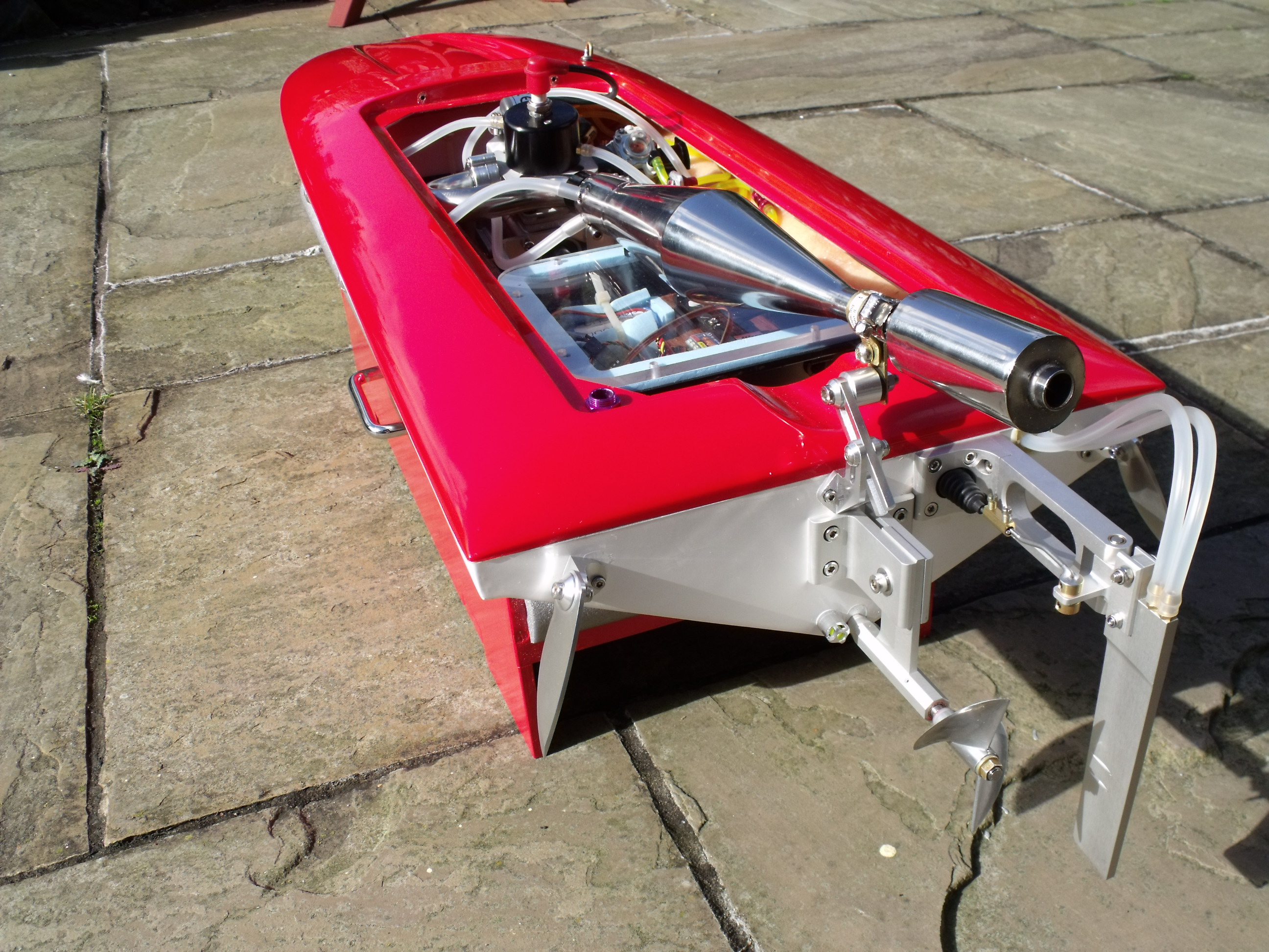

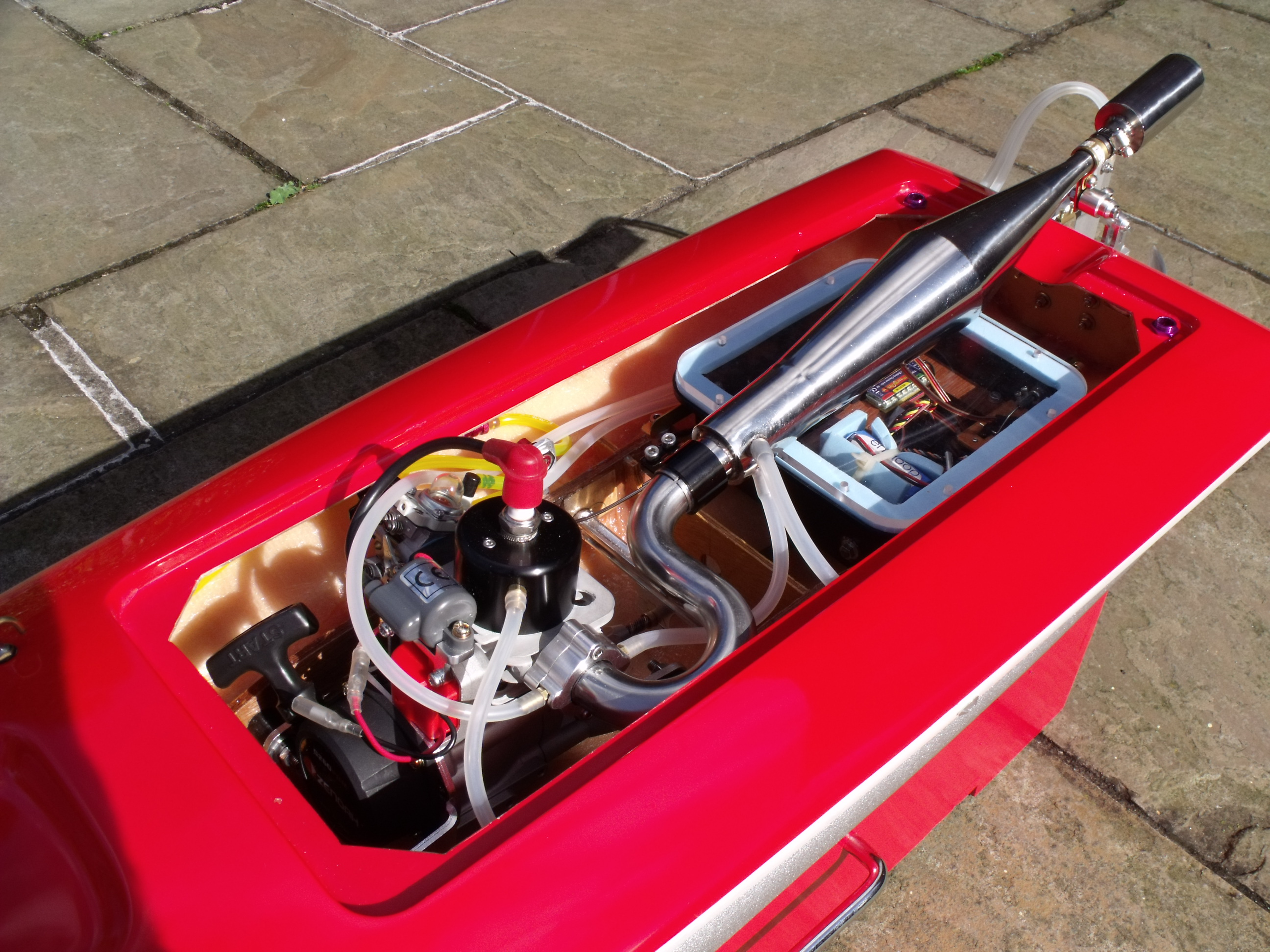

    Hi Darren
    I use a dual pick up from the rudder. The first circuit goes straight to the cylinder head jacket and out of the boat.
    The second feeds first the manifold joint then the pipe cooling jacket. No problems so far for me with this set up.
    The exit points for the water outlets are deliberately well apart so that I can see water exiting from both circuits when running the boat.
    Here's a couple of photos to show my set up:
    If you double click on the images you should be able to zoom in for finer detail:
