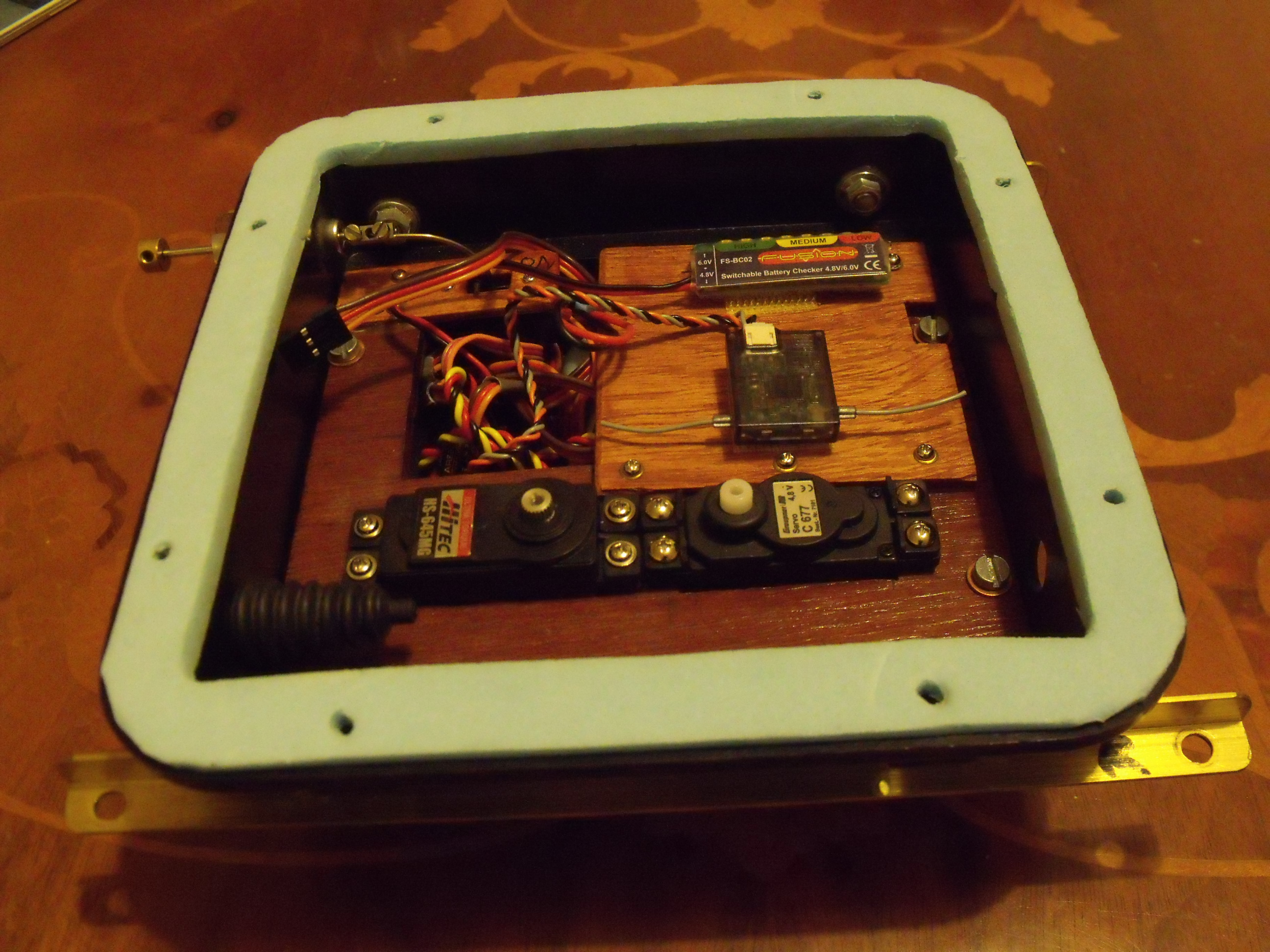

Craig forgot to ask what type of radio box you using?do you have a pic? Darren

dazzido wrote:
I use a bog standard plastic box. However the brass angled rails are permanently bolted and epoxied to the outside. Four bolts go into alloy studs (glassed into the hull) to hold the box in place making for quick and easy removal.
The only potential water entry points are:
1) Hatch foam/perspex lid.

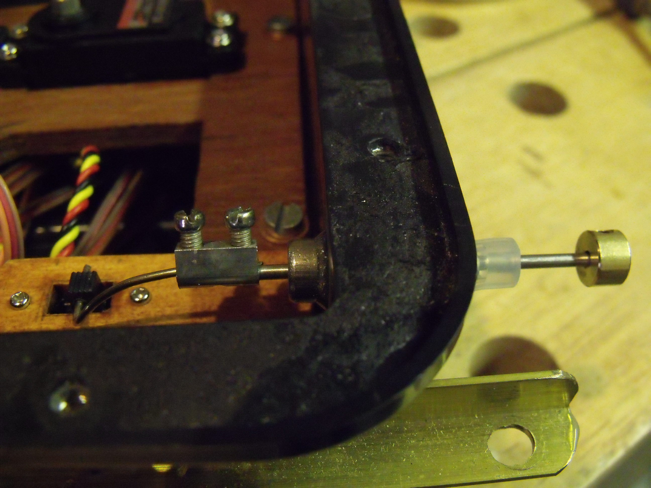

2) Two bellows for throttle & rudder rods.
3) Entry point of rod that operates radio switch (minimal risk).
Pushrod for Radio Switch:
