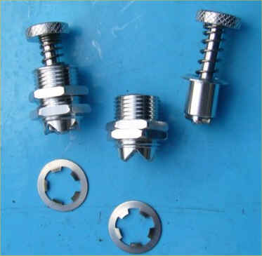

My preferred choice is the conventional push and turn latches like these from Prestwich Model Boats:

I was thinking of using push and turns but they can be too secure. If a hydro crashes at 70+ mph the cowl/boat can be damaged. The magnetic latch would not hold the cowl as secure and let it seperate. Just want to reduce the amount of damage in such a crash.

The magnets work very well if you get strong enough mags and line them up perfectly flat. Personally on most of my boats I like to go with mags or Orings. Usually go with Orings on race boats where looks aren't so important yet functionality IS. The Orings will hold cowl through about any racing, but will break on impact or flip.
The pushdown cowl locks are nice, but trust me they WILL tear a few big holes into your cowls when you get in a good hit/flip.
