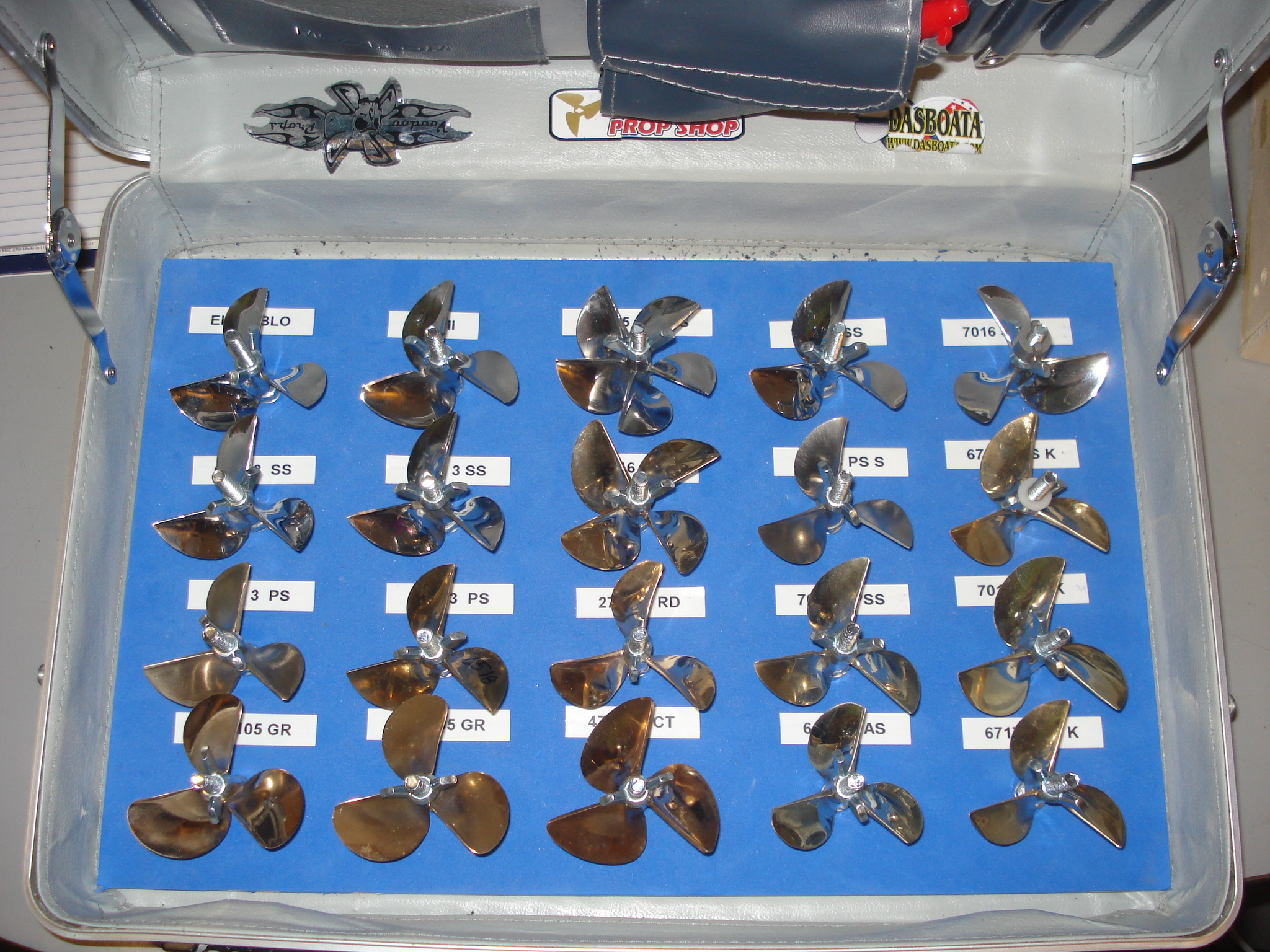

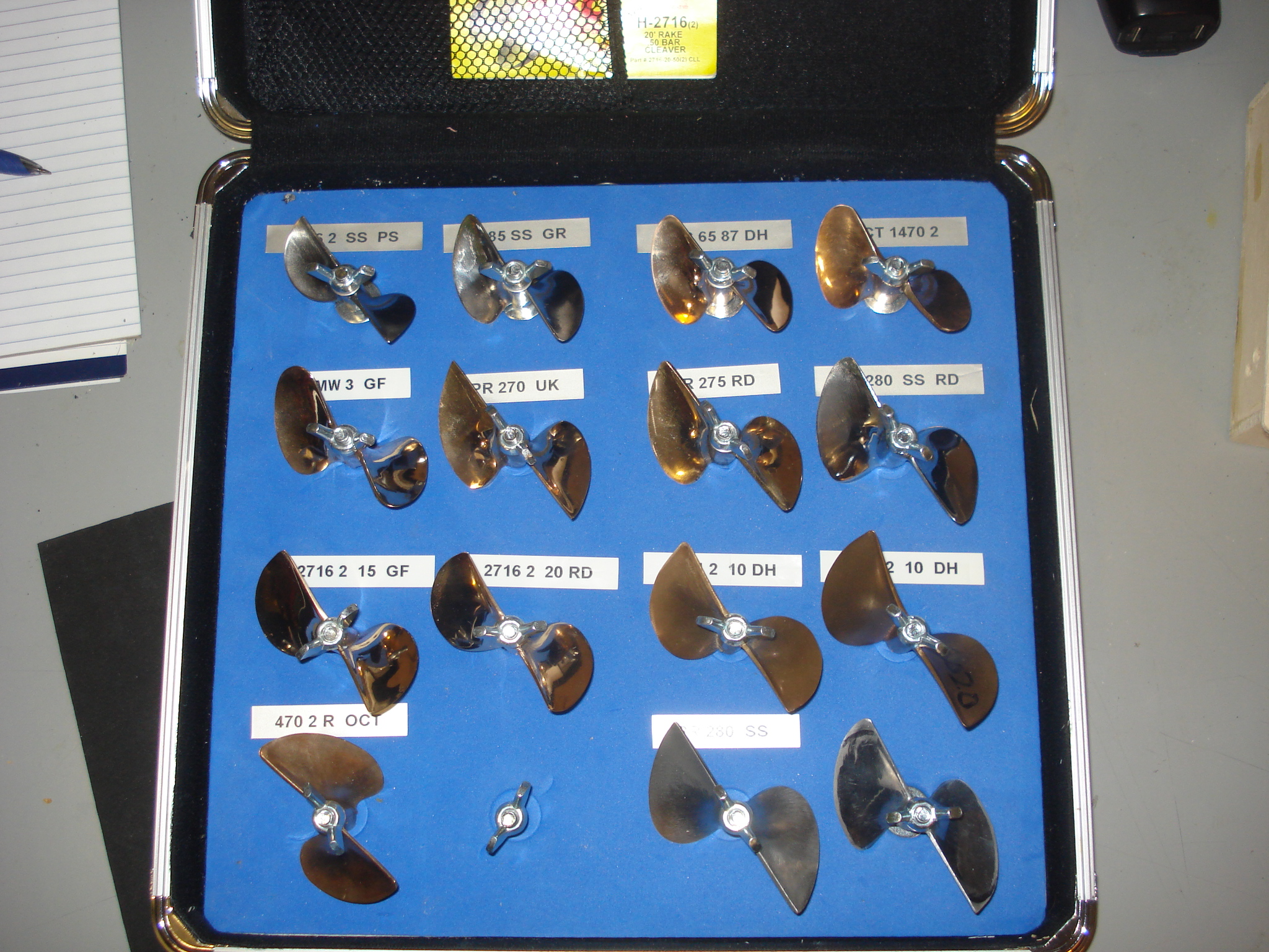

Canadian Hot Rod RC Boats replied the topic: Re: Propeller best polished or left satin/mat?
I have all mine polished -- the one's I have bought from Bob English (several now) all came polished - from Dave Marles all came polished - the one`s from VooDoo all came polished
I think a lot of it is how u polish and like most here said
u have tried both and no diff - and that u `could`round the edges - both statements say the same no actual diff.
Same reason I paint with Automotive paint and some paint with spray bombs (u will never get the same finish from a spray can) - to me they just don`t look finished without polished
And if there is no diff ........... then I`ll stick to polishing

Craig Dickson replied the topic: Re: Propeller best polished or left satin/mat?
Hi folks
Thank you very much for taking time out to comment. Some good advice has been given here as well as your shared experience.
I am massively impressed with the prop collection from Canadian Hot Rod and I love the neat storage system. I’m pleased that I am not the only one who loves the shiny props!
