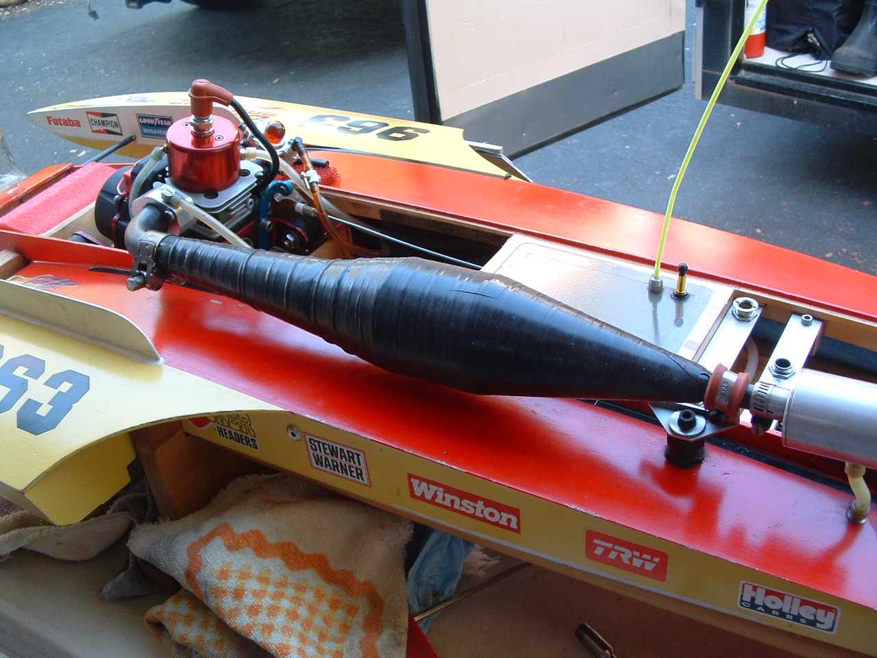

marc replied the topic: Re: Heat protection in a wooden boat?
"No soup for you!" ha ha...I like that...been a while! :laugh:
Anyway, yeah, I would suggest trying the silicone wrap like Scott is showing, or the one from Carmen which is probably same kind of stuff. I think they will do fine in most situations, AND, they will be MUCH easier to apply and keep on the pipe! If that doesn`t shield enough heat then go FG.
The fiberglass tape shown in the article link above was a bit tricky to get on the pipe evenly and get it to stick there withou sliding off the cones! :) As far as heat barrier though, the FG tape is unbeleivable...bring the boat in after a long hard run and grap it by the pipe if you want! Works awesome!
