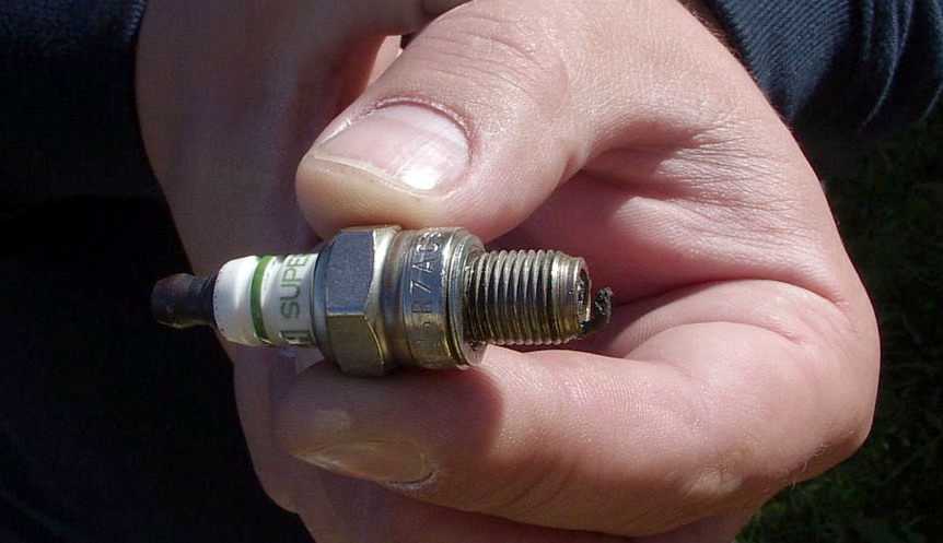

Friends,
I met this topic about BOSCH plug.
We have a very unpleasure experience with BOSCH, engine JG 26 on Zenoah end was damaged.
It was 1 (one only) run on full throttle.
A small part of central electrode was broken inside cylinder and broke a piston and liner.
Day of race was finished to very fast boat.
The BOSCH is a very good name, but I never use it in my boats.
Sorry about it.
