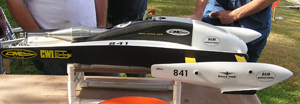

We currently hold the NAMBA GX2 SAW record. There is an article on the engine development program here:
www.modelgasboats.com/Magazine..._Record_Engine/
We used an outrigger hydroplane to go 105 mph. Testing the same engine in an Aeromarine Cyclone cat got into the high 70 mph area. Both speeds can be improved on, but it will take a custom prop or a gear up drive to get much over 100 mph.
Lohring Miller
