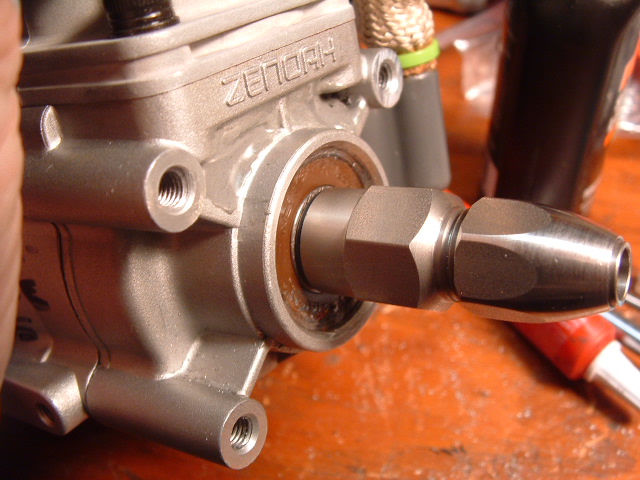

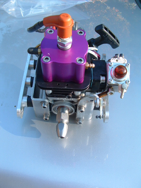

Scott replied the topic: Re:Engine and collet connection
Aeromarine makes many types to fit many engines ....
here picture of the correct one mounted on an engine ;)
