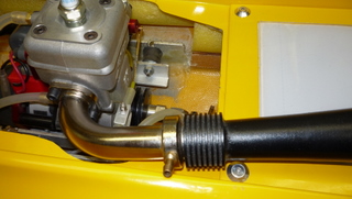

Is there anyone out there that knows the correct way to mount a CMB pipe to the manifold.

I haven't had any experience with CMB gas engines, but for my two cents worth. If you cannot find any clamps that will suit, you can use the high temperature silicon tubing and cable ties that are available for gas (or nitro) engines.
Hope this helps.
#11859
CMG replied the topic: Re:CMB 26 Gas pipe mount
Hi
thanks for the reply. I tough of that but the two water nipples might be a problem.

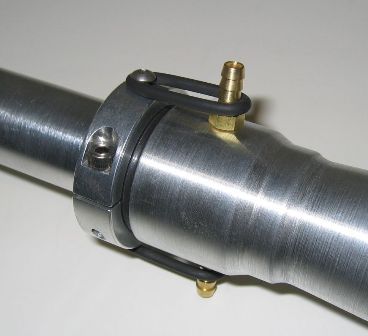

With pipe fixing - I can just suggest to do 2 C-shape clamps with screw, analog of B.H.Hanson pipe stopper.
Good luck!
[img] [img]http://www.modelgasboats.com/media/kunena/attachments/legacy/images/clamps.jpg[/img]
#11875
Thanks it looks simple enough and thanks for the info regarding the running in procedures.
