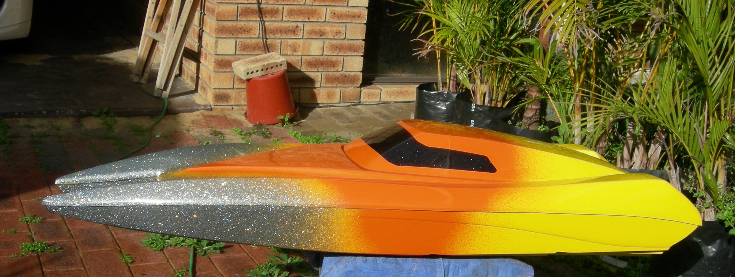

i have the same 52 forabuck hull with a mid modded motor and pipe with the balance point was already set @ 32% from past owner ... and it always runs wet ... got sick of adjusting it and getting no where so i just left it and have fun :)

marc replied the topic: Re:engene placement on a cat hull
Doesn't look wet in that picture! Don't see ANY water coming off the sides of the sponsons. :) Could be simple a prop issue. Just a thought.

seahawkwa replied the topic: Re:engene placement on a cat hull
ill agree also with marc, it looks fin.
ive got my hull set at 32 persend and run in on ruff water . if running down wind on flat water it dose loose top end but running it in to a strong head wind it goes great dosent run to high or to wet at all. yes i did have lots of trubble with prformace but that was because of a over worked crappy motor i had perchased of somone . i ended up running it with a stock motor tuned pipe and a 7016 prop and it goes realy good. for the stock motor . im looking at trying my omin race motor in to it soon and see what i can get out of it. now you have me thinking i might do that this week and will let you know if it goes as fast as my 56 apache with the motor out of it .
also is that a mono hull in the back ground . remember a cat will always ( i think) run flatter then a mono. as there dirent hulls. but you might want to just try props . i realy now after lisoning to the posts from mark and scott and other racers props realy do make the world of diffrence.
