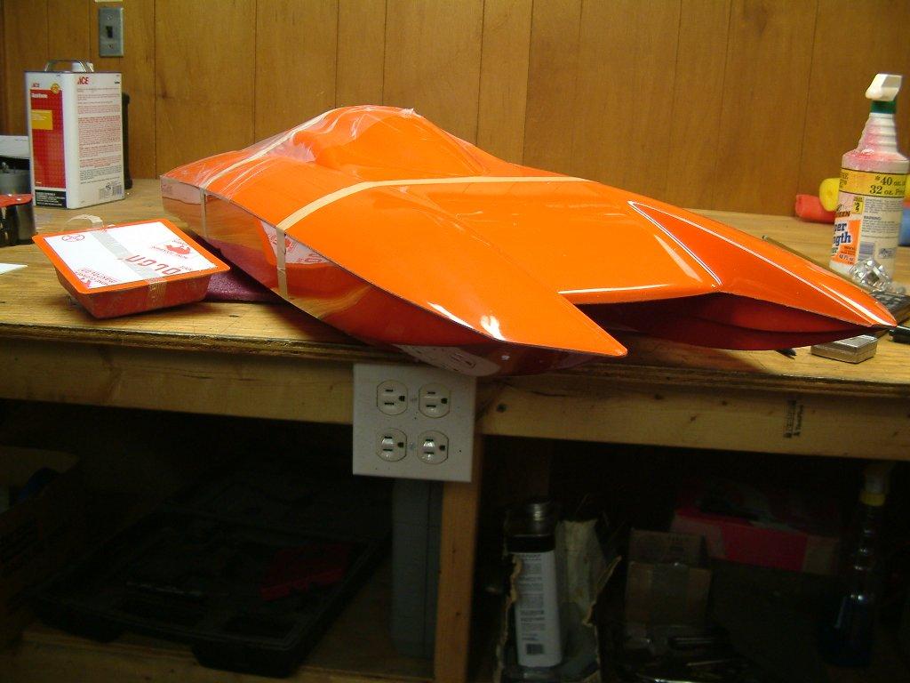

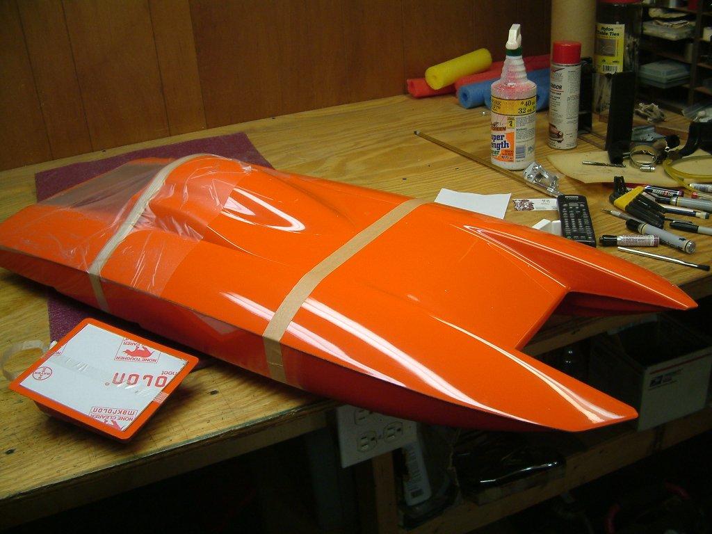

I have recently purchased and am the proud owner of the very first all "Happy Orange" R42 to be produced by AC Model Boats.I would like to thank Dom (ACLazer) for arranging all involved over there making for a very smooth and pleasant transaction. A big thanks needs to go out to Andrew (Faster) here in Melbourne for communicating with Dom and assisiting me with the freight to get her here safley at a reasonable price.
Their service and advice has been first class, thanks guys and look forward to working with you to produce and build another fast oval racer cat here in Australia.
Here are a few pics taken from Doms work bench, I think.
...any comments, suggestions, advice and feedback are always welcomed.

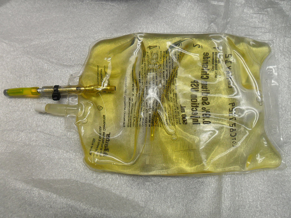

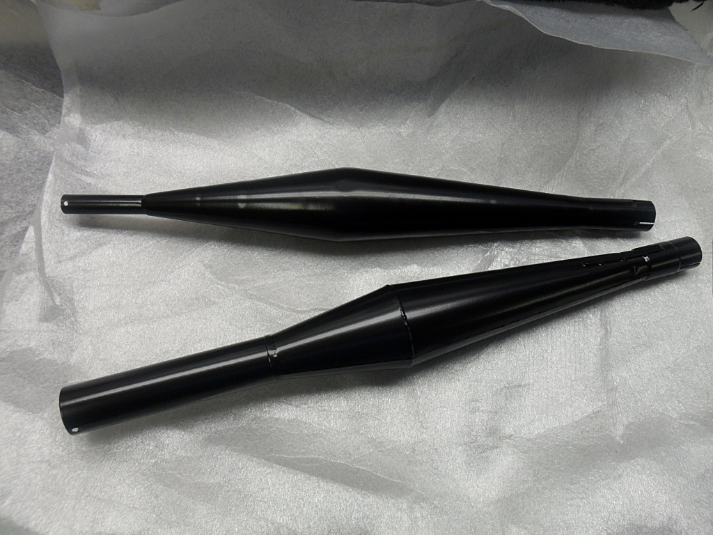

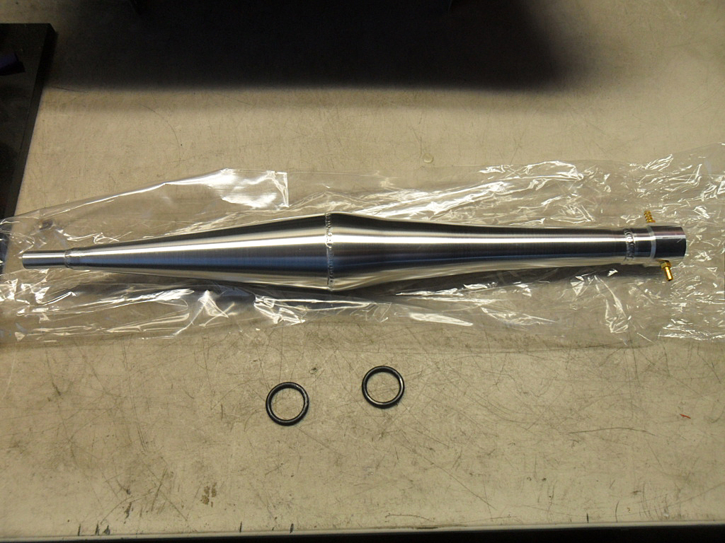

...picked up both pipes this afternoon, hows that for a same day turn around! Both the Victory pipe and the M&D have come up great once again. Fuel bag and the insert that I made are sitting idle for the fuel to soften the bag for the first time and to check for leaks.
...and my new Cooper Cobra. Great service from Cooper Pipes and I have now three great pipes to try out on this new build. Steel VS Aluminium, looks like some serious time will be spent testing when she hits the water.
