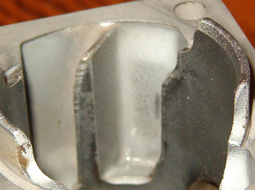

rocket ron replied the topic: Re:Engine Stalling when letting off throttle from WOT
Yeah,Scott! I noticed the mounts have gotten a little soft,and ordered replacements. I removed the engine today and tore it down. The area between the transfer ports is real rough on the lower part,and the piston ring dosen't look like it has seated in a few places. I can't get the three screws loose from the engine "block" on the front plate. They may have thread locker on them. I'm going to order a new "stock" engine,then go over this one later. Will the new 257 carb work well on a stock engine? I really like it not having a choke plate to mess with. Ill try to get a picture of the rough area up on the post Thanks Ron
Here's a pic of the cylinder. Ron

marc replied the topic: Re:Engine Stalling when letting off throttle from WOT
Not sure if you posted this and I missed it, but what is your High speed set at? I would run that carb at 1-1/4 on Low and 1-5/8 on High. I am getting the feeling you have to run it fat because of an air leak. I would start with surfacing the isolator block on both sides and checking it for trueness on a piece of glass. Also double check the water pump fitting in the iso block and even cap it off to eliminate that possibility. Make sure the pulse passage is clear. Last check cylinder gasket and crank seals for leaks. Of course do not forget the fuel delivery...check it all for leaks...air bubbles in the gas lines are not good. If you are using a quick fill valve, take it out of the equation for testing. Keep us posted.
