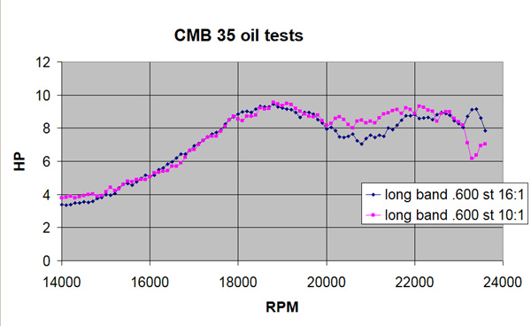

Many years ago Mike Hoffmeister did some dyno tests and found that a higher oil content improved power, probably because it improved the piston seal. We confirmed this on several engines. Even 10:1 may still help. The difference isn't much, but it's measurable.
Lohring Miller

BillSOCAL replied the topic: Re:Correct oil to gas ratio?
I'd love to see this same test with data for 32:1 AND 16:1 for comparison.
Several years ago a manufacturer of large (100 cc+) 2-stroke engines for airplanes did a similar comparison. He used 50:1 (recommended by oil vendor) and also 25:1 ratios. He found that the big air cooled engines ran hotter with more oil and produced less power. But these engines only turn ~7,000 rpm and do not see the loads of a boat engine
But at some point there must be a power loss since oil takes the place of fuel, and the more oil, the less fuel there is to burn to produce power. I wonder how high the oil must be before power starts to drop off??

lohring replied the topic: Re:Correct oil to gas ratio?
I've lost the data for Zenoah oil tests when we changed computers on our dyno. With the higher oil mixtures we just richen the needle slightly. In small engines, factors like piston seal and ring friction overshadow many other factors. Quickdraw was able to improve power during the development of our SAW engines by changing the hone pattern on the cylinder.
Lohring Miller
