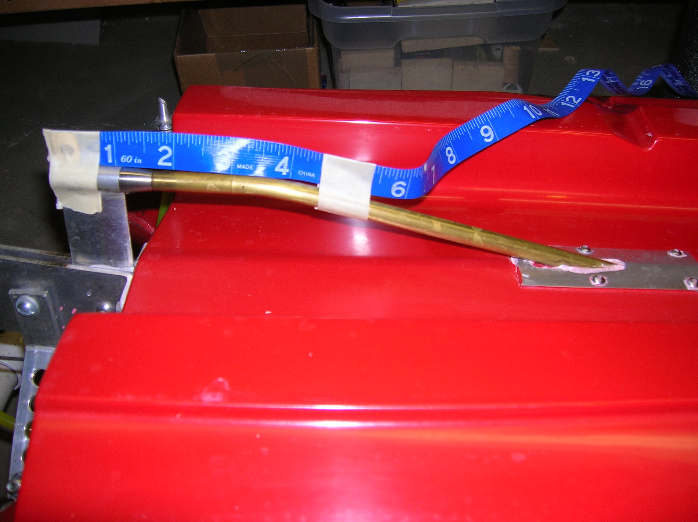

Post some pictures of your setup so we can see and help point out problems if we can see some.
I would be looking at bends in the tube that are too steep or too close to the strut. Also would consider going with a non-lined stuffing tube as mentioned above. 5/16" K&S brass tubing is what most of us use, and you can make sleeves for it with 11/32".

I'm not really sure if the breakage would be more on one side as opposed to the other, I never really had that problem...sorry I can't be of more help on that one. As for the bend close to the strut, that's always a bad thing. You should have at least 3-4 inches of straight tube going into the strut. Bends should be forward of that. Otherwise it puts a LOT of stress on the cable because the propshaft is solid and straight, plus the first 1 to 1.5 inches of flex is hard also due to welding. I never bend a tube close to the strut.
As for taking the liner out of the tube, if it isn't too damaged, it usually will pull out. The brass tubing in this case is 11/32". This CAN be used as stuffing tube, but usually we tend to use 5/16" to keep a more "snug" fit for the cable and prevent "slop" which can also lead to premature wear. It all depends on the length of the tube and the bends. Hope you can get the pictures uploaded. :) Would help a lot.

Thx for the information I didn't know that the drive dog to strut spacing was 1/4 inch, I have been setting mine to 1/16 inch. Here are the photos of my set up and most recent shaft breakage.
