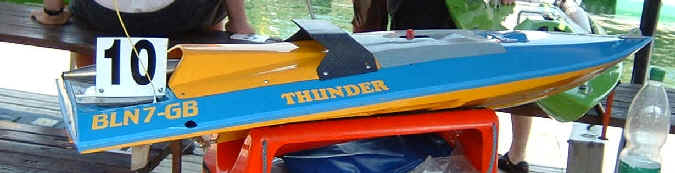

Big difference between submerged and sub surface :laugh: ,submerged is best for rough water handling for sure and also turnability but slower.FSRV boats run this and they kick the ass of any surface driven boats on m shaped courses,even in oval races so much so they are banned from racing oval races against surface drives in europe i believe because they lap so much quicker.They turn in their own length even at full tilt without flipping.They are a different animal to your average vee though,not my cup of tea but awesome to watch all the same.

martno1fan replied the topic: Re:Surface prop vs. submerged
typical fsrv's with fully submerged props.
You may not like em im not fond of the looks but id betthey will kick a surface drives ass round any course.
