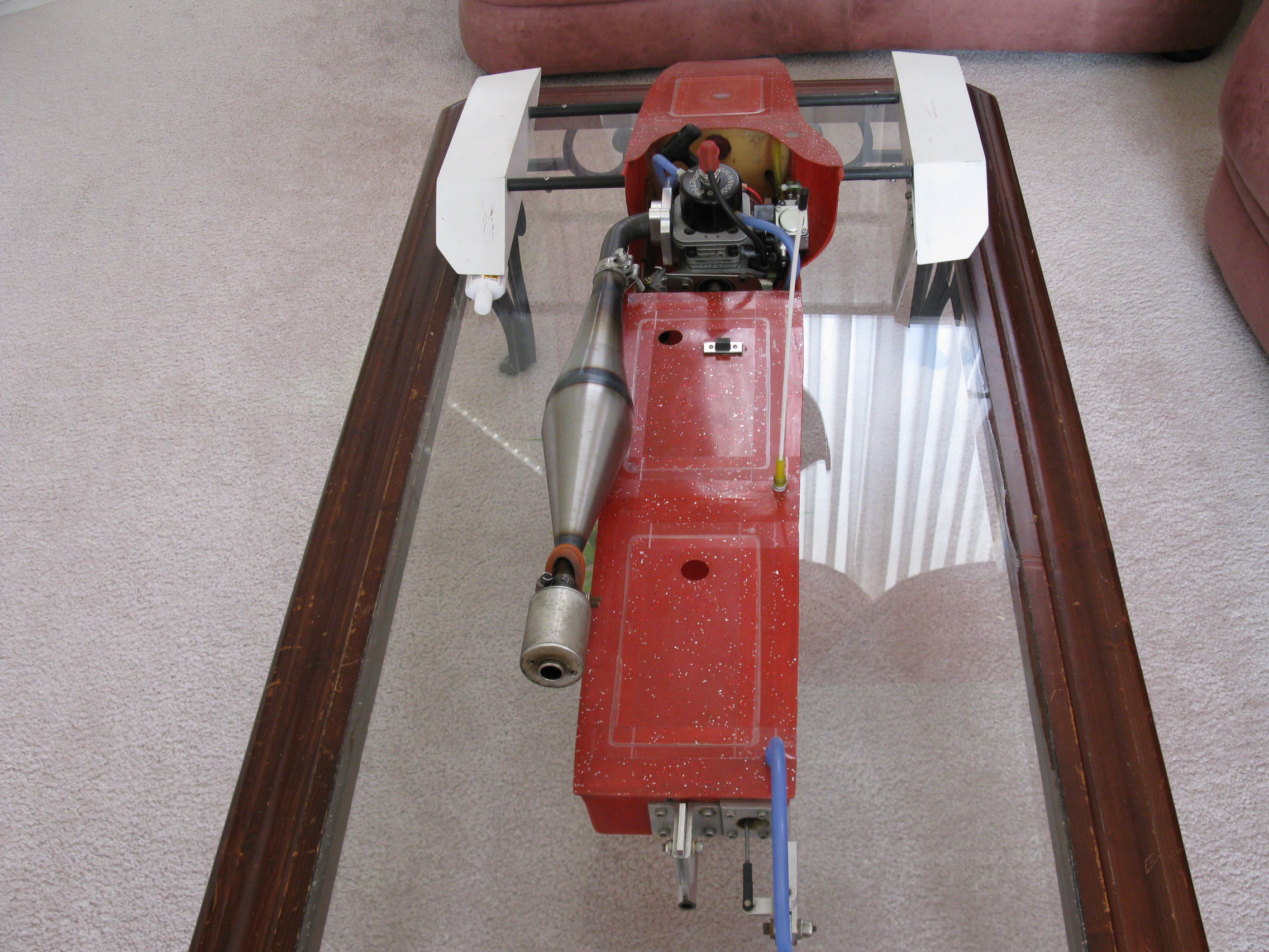

ken0276 replied the topic: Re:help rigger
Moofy07 wrote:
Here is my 38" rig look, it launched so easily with a right engine placement and props.

Scott replied the topic: Re:help rigger
Midwest missile II .... Great boats in spite of being so small :drinks:
