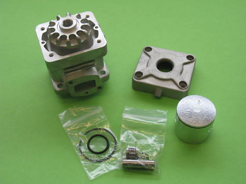

david36pt replied the topic: Re:RCMK Engine Modification
Hi guys
Hope everyone okay.
Need some adivise : have a 26cc crrpro engine marine i buy a rcmk kit head complet with head and piston .I m going to have major problems or its easy?
Many regards from Portugal
#13950
Ozpulse replied the topic: Re: RCMK Engine Modification
Youve got the whole kit so as long as the cyl. bolt pattern is the same, stroke etc. it shouldnt be a problem.
One of the engine gurus on here will set you on the right path! ;)

david36pt replied the topic: Re: RCMK Engine Modification
Many thanks
If one guru can give the steps and upgrades possibles to do in this items i will be very apreciated!
