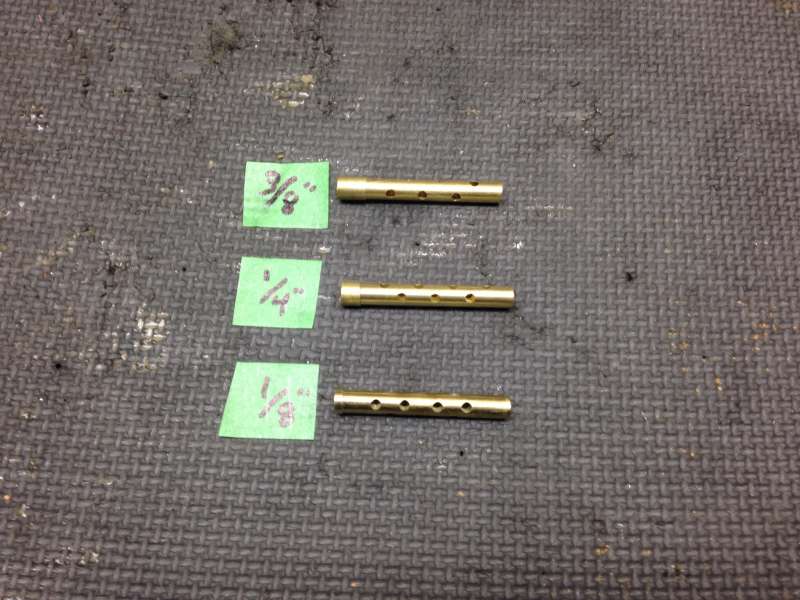

HarleyLou replied the topic: How to secure brass bushing in strut?
Something like these?

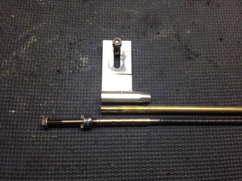

I have a strut like this
That I insert a stuffing tube with a reduced end like one of these
I can only insert the stuffing tube as far as the reduced tube allows anyway? The bushing seems to slot into that reduced section a bit once pressed into the strut.
I figured the perforations where there to create a grease cushion for the propshaft. I never thought that the bushing was meant to spin.
What's the idea of the longer shoulders on the bushings in the other pics posted by HarleyLou?
The 3/8"&1/4" bushing in the Picture was to help understand what you were asking for. Most use 1/8 Strut Bushings Collared or Flared. If your 5/16" stuffing tube won't fit in the Strut, drill it out. Should look like this when done.

Motorboater replied the topic: How to secure brass bushing in strut?
Now I get it. Picture says a thousand words, thanks for that B)
