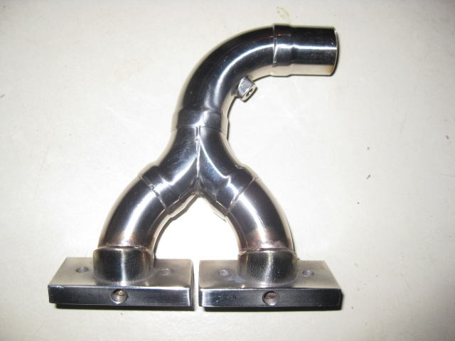

engine: MOUSE HOUSE with RCMK-tops of first lot, slightly modded.
cooling flanges: my own, see my webside
header tubes: 0.5mm stainless steel, outer dia 22mm, by a german dealer, connected via laser welding and hard soldering by myself
header itself: water injection, 0.8mm nozzle
pipe: modified german stainless steel pipe
Note: center distance of MOUSE HOUSE is the smallest world wide as I know, RCMK and MTC twin do have a larger one. That means that my 2in1 headers do not fit these brands, other dealers or manufacturers should think about a production, a water injection is definitely a must due the doubled energy thru the pipe and the pipe must have a bigger volume to handle the increased volume (increased by water / steam).

MATHO replied the topic: Re: 2 into 1 header for a gas boat?
my new 2in headers have an inner diameter of 21mm.
This diameter will work but a normal pipe with diameters of 50 or 55mm won't work. My new pipe has a diameter of 65mm (meeting point of the 2 cones) and 60mm at the damper section and is a bit shorter than usual because the header must be a bit longer.

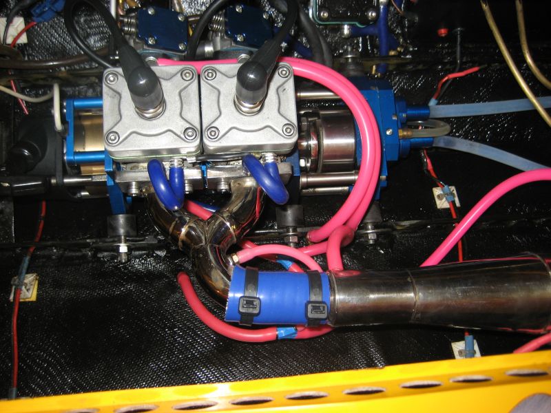

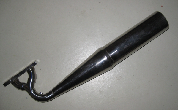

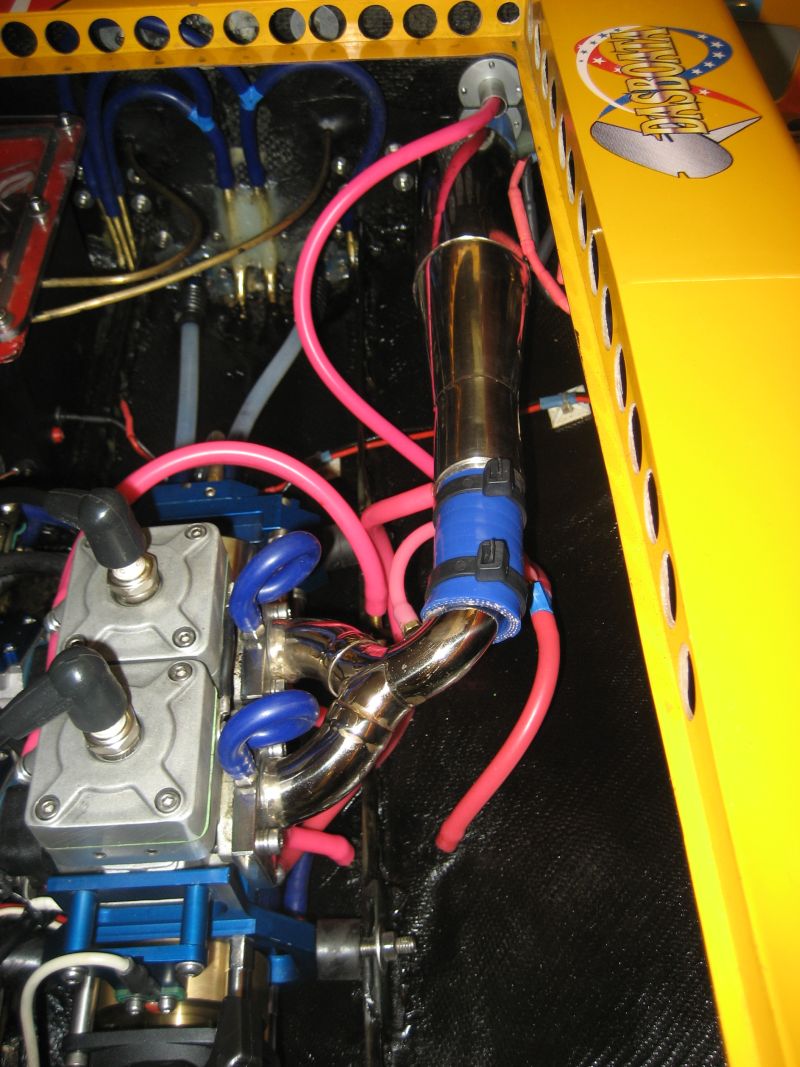

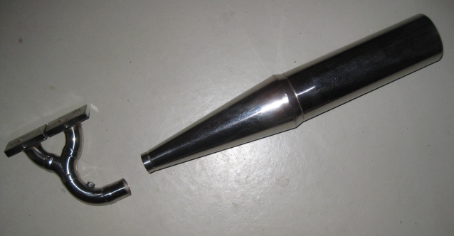

#18924
here we are...

smokeater2005 replied the topic: Re: 2 into 1 header for a gas boat?
WOW! That is perfect!
Matho, will you be offering this pipe for sale on your site?
I would also be interested in buying a pair of the 30 degree water cooled header flanges if you can confirm mounting compatibility to the RCMK K600.
As it stands now it is the only, I am guessing 55-60cc, wet pipe I have ever seen.
I believe that I can have the headers made to match the RCMK K600S that I am drooling to get my hands on and use in my boat. But that exhaust pipe im sure no one I know of could fabricate with the performance and knowledge you obviously have on rc boats.
My rough guess is that the pipe shown is about 12-13inches long which would be most perfect for my use.
Question: are you using 90, 100, or 105 bend pipe to make the headers shown?
