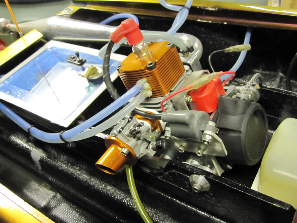

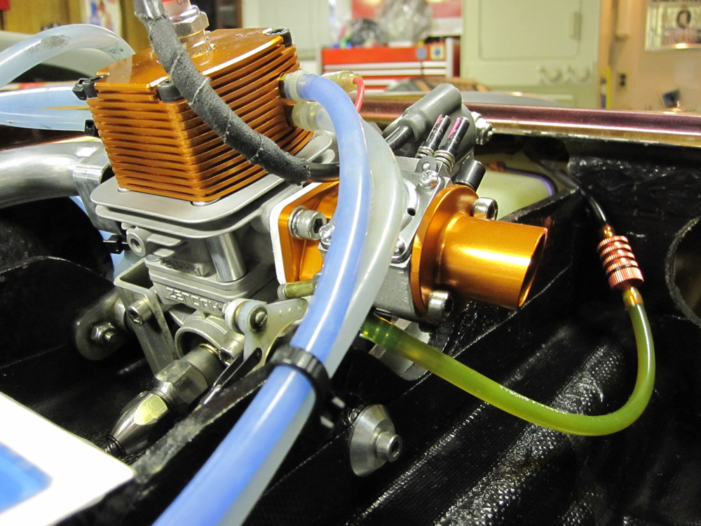

Could you upload a photo of your engine & engine bay? It might show something not apparent from words alone?

Here is a pic with 257 carb
