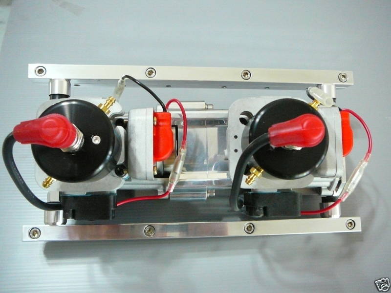

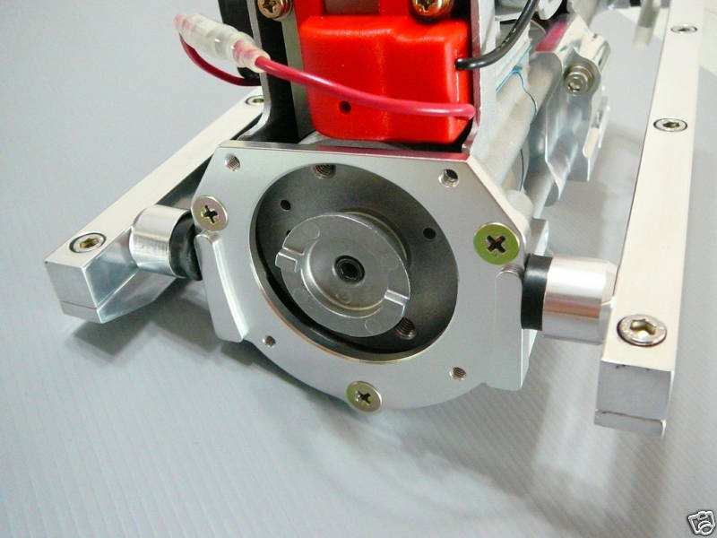

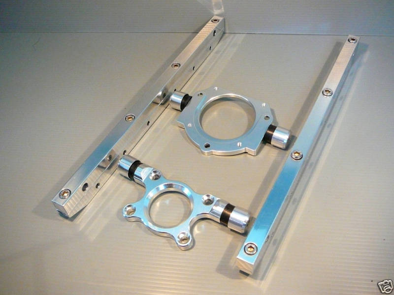

Here is a twin inline mount which is a nice setup for removing engines - I use their single in a lot of boats
#17426
Steve Seebold replied the topic: Re: Top Secret Boats
That looks like a nice mount, but I think it's WAY overpriced
#17431
Scott replied the topic: Re: Top Secret Boats
Still only 4 rubbers and small ones at that in spite being within containment cups :huh:
With the purpose built inlines the like of MTC / Matho / RCMK the mount market is likely weak at best having the former 2 of the list making there own leaving just the S520 RCMK.
The mount GIZMO sells using HARD 1" diameter rubbers is tough as nails and does quite well.
As for joined single engines ... tough one there being those making joining parts have come and gone like the wind these past couple years :blink:

Canadian Hot Rod RC Boats replied the topic: Re: Top Secret Boats
I agree on all points I was only showing some other mounts out there. The inline one is way overpriced and 4 mounts
Just showing some other type of mounts
Scott would have a better idea than me on the inlines

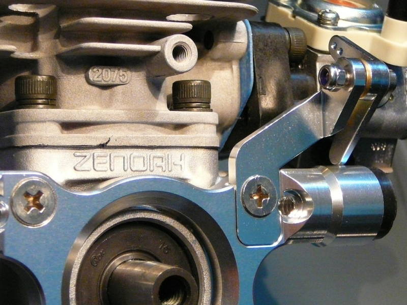

I added picture of the single machined mounts ...
#17442
Here is those machined mounts in a single mount i use .... very easy in / out
