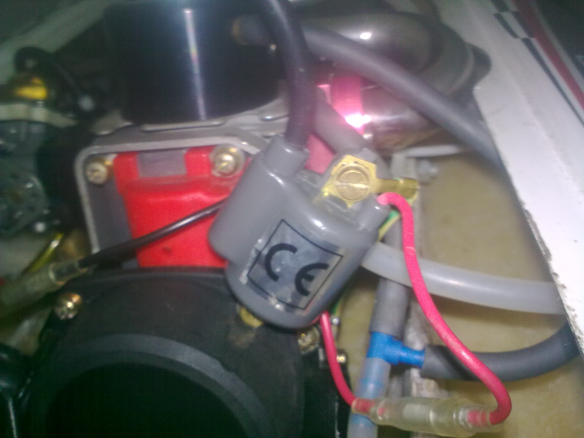

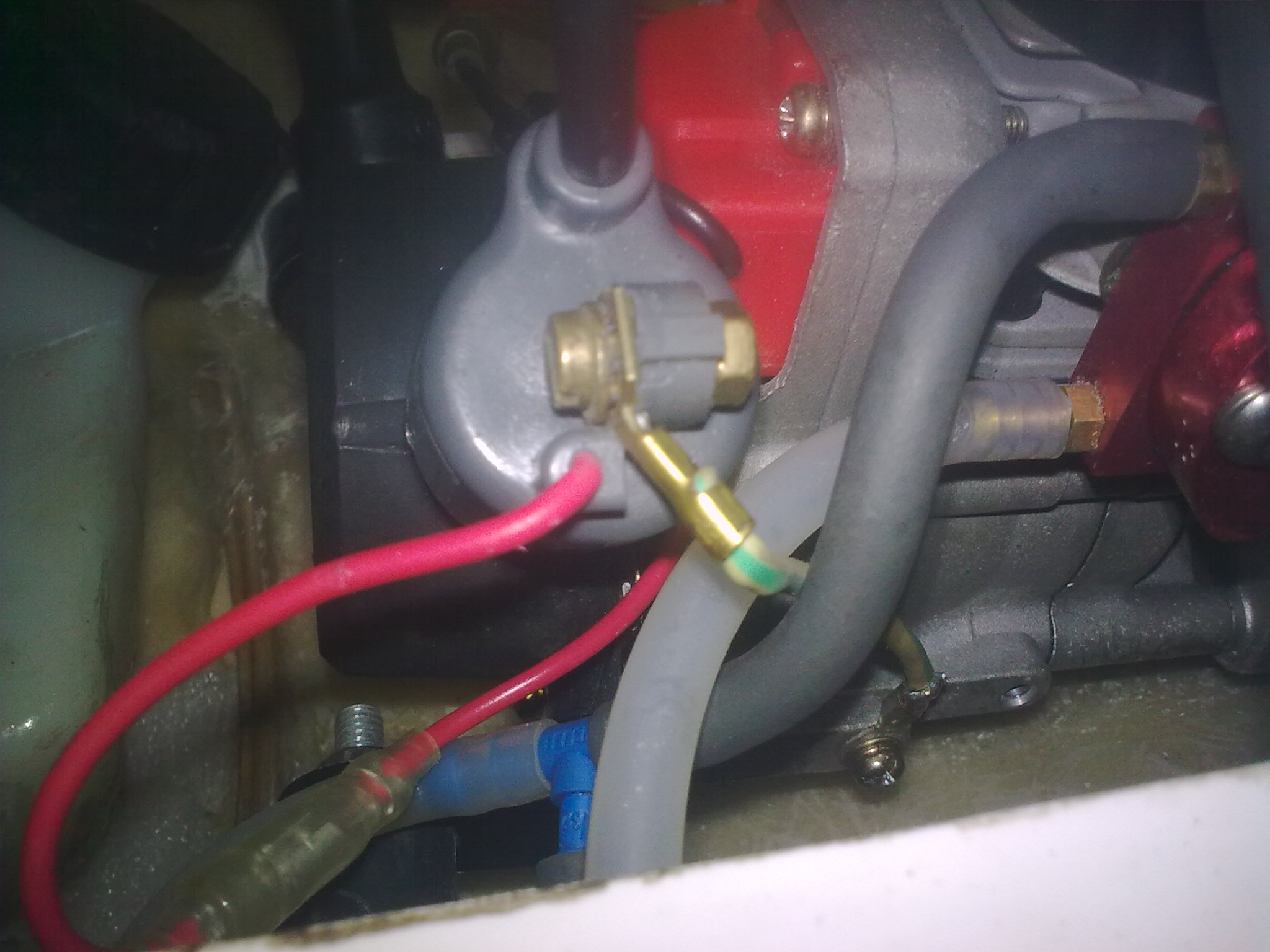

But now a problem has occurred with the ignition system. The engine runs for maybe a minute (and roughly at that) and then cuts out. We did a spark test and no spark was being generated. A few minute later a spark was being generated but then stopped again. After fitting the proper spark plug connector I had to move the coil as the spark plug lead was not long enough with the new connector on it. The earth wire I fitted to it was loose and after tightening this again there was a spark once again and the engine ran but after a minute or so gave up again....once again spark test showed no spark.
We suspect the coil (grey cylinder) is quitting or is it something else in the ignition system giving up. Is there any way to test this and if it is gone where can I get quality parts to replace the broken ones.
The suspect.
The earth wire i installed.

Clean and tight connections of BOTH coils to crankcase. added grounding jumpers from secondary coils brass tab to case a GREAT add on. ... TIGHT bullet connector too !!

Grey coils have been known to do this kind of behavior...work for a bit then give out, then work again as they cool back down. There is a good chance it is the culprit. I would just order a new one...it's also a good idea to always keep a spare on hand.
Sounds to me like you only just discovered this issue now cause you couldn't even run the boat before you fixed the interference problem...correct? The old connector on the spark lead kinda leads me to think the previous owner might have been chasing the same gremlins. :)
Change that coil altogether and get a new resistor plug and go have fun!
