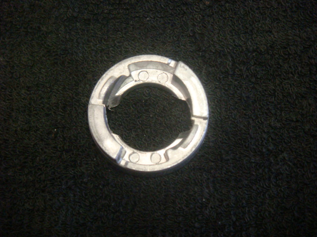

I have a warehouse hobbies enforcer team pro with their M5 zenoah 26. I keep breaking the paw for the recoil start and was wonder would one of those ez recoil starters have enough torque to turn it over?

They make a metal pawl for Zens
www.gizmomotors.com/index.php?...emart&Itemid=56
usually when it happens to me it's been a issue with spacing of recoel assembly or the way the guys pull .... my nephew jerks his hard without engaging it slowly first and breaks lots ...

jmfairbanks replied the topic: Re: EZ pull for zenoah 26
Thanks for the info Randy, I seen that they make metal ones and that is one of the options im considering. I keep seeing these videos of people starting their boats without even having to hold on to the boat itself. All they are doing is just lightly pulling the handle a few times and it starts right up, to start my boat i have to hold it at the motor and usually have someone hold it near the back because it takes so much force to pull it
Woodie, I out the choke and I give it a half pull 2 times and the engine will pop, then i turn the choke off and it will take 2 pulls at most and it will start right up. I always make sure to take the slack out of the line before i pull it also. This engine has 135# of compression so i dont know if that has anything to do with the piece breaking. This is my first Rc boat and its seems to be turning into a passion
