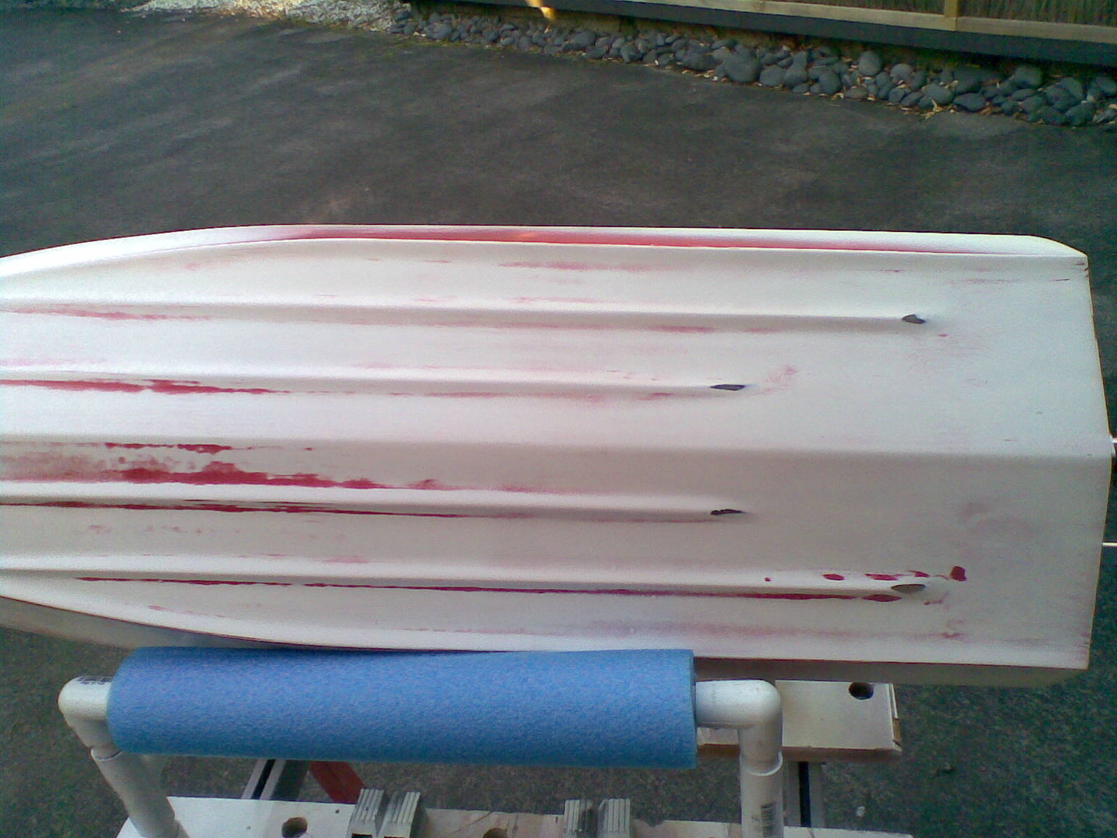

David McIntyre replied the topic: Re: Counter rotating props! Help me!
Woodie,
Here are some pics of my crappy hull. Taken from a phone.
You can see how I cut my strakes back from the stern in a V shape.
#14834
Woodie replied the topic: Re: Counter rotating props! Help me!
Thanks David.
You are a great help to me, and I really like that you confirm some of my own theories.
Also thanks for the informative picture. (Crappy? I don't think so. It just needs a little paint) :)
Yes, a nice bright green is my goal.
Just a final wet & dry and to go, then it's time to see what painting will cost.
