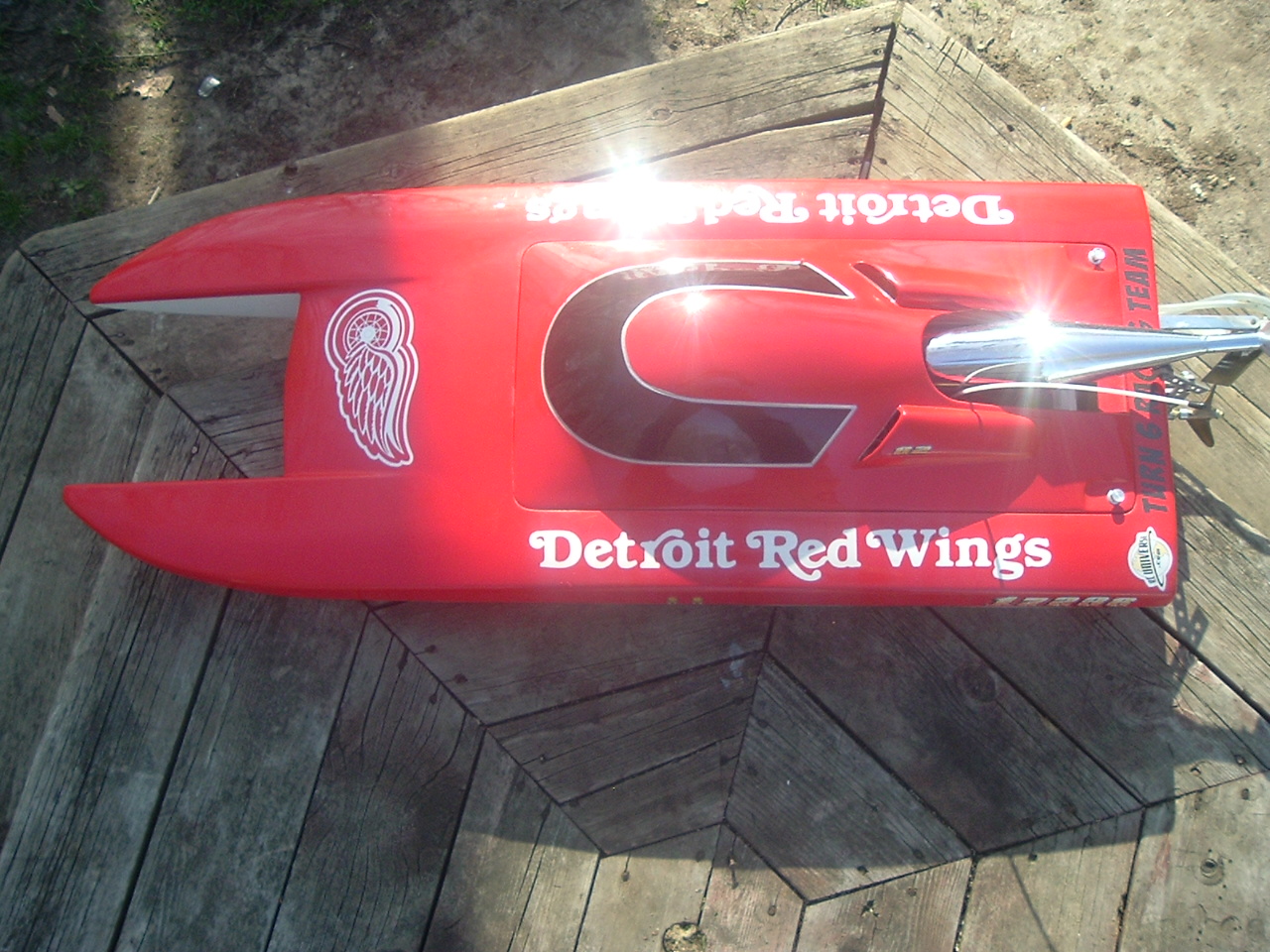

Laugh if they will but I've been running a Profession Model WTC pipe on my Falcon 41 with RCMK power. For a low-buck eBay Chinese pipe, it works rather well but is loud unmuffled. You can see it when it comes on the pipe as the front end will jump up.
