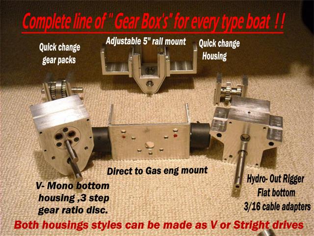

2speed replied the topic: Re:Gearboxes?
The boxes can be built with up to 15 different ratios and gear combos, that will fit into the same case measurements. I rate the ratios in RPM percent increases, it starts at 7% up to 42% the most popular range is 25,27,32 and 36 percent.
The cost is tough right now. Machine shops only talk if you order a 100 or more units at a time,and I have 4 styles and hull types.I'm waiting for a quote for single units. As it stands the boxes come in around $180 and the 2speeds about $225. They are adjustable to shift any rpm you need. To be get better handle on the price. I need to know what type and style your looking for. Understand I've spent 3 years developing this interchangeable gear system so you don't have to buy a hole new unite to change your setup .Each setup produces 3 to 4 different ratios and as I said earlier thies 4 different combos.
I hope this photo can give you an idea of whats avalable to work with and you can email me at This email address is being protected from spambots. You need JavaScript enabled to view it. with any ? you might have on mounting or setups.
2speed-out

Woodie replied the topic: Re:Gearboxes?
OK. I admit this is worth considering.
But I have questions as: Should the gear be controlled by remote set to an extra servo on an additional channel - or will it work automatic at some rpm? Like some kind of clutch? How many rpm's and hp's can the gears manage?
Even more important: How about some links to on-line shops? Some specifications? Some prices? In my case in the EU? Nothing can be sold without marketing, that tells you excactly what you get for your $$.
Or did I miss something in this debate?
(2-Speed: I see you do your best, and I respect this).
